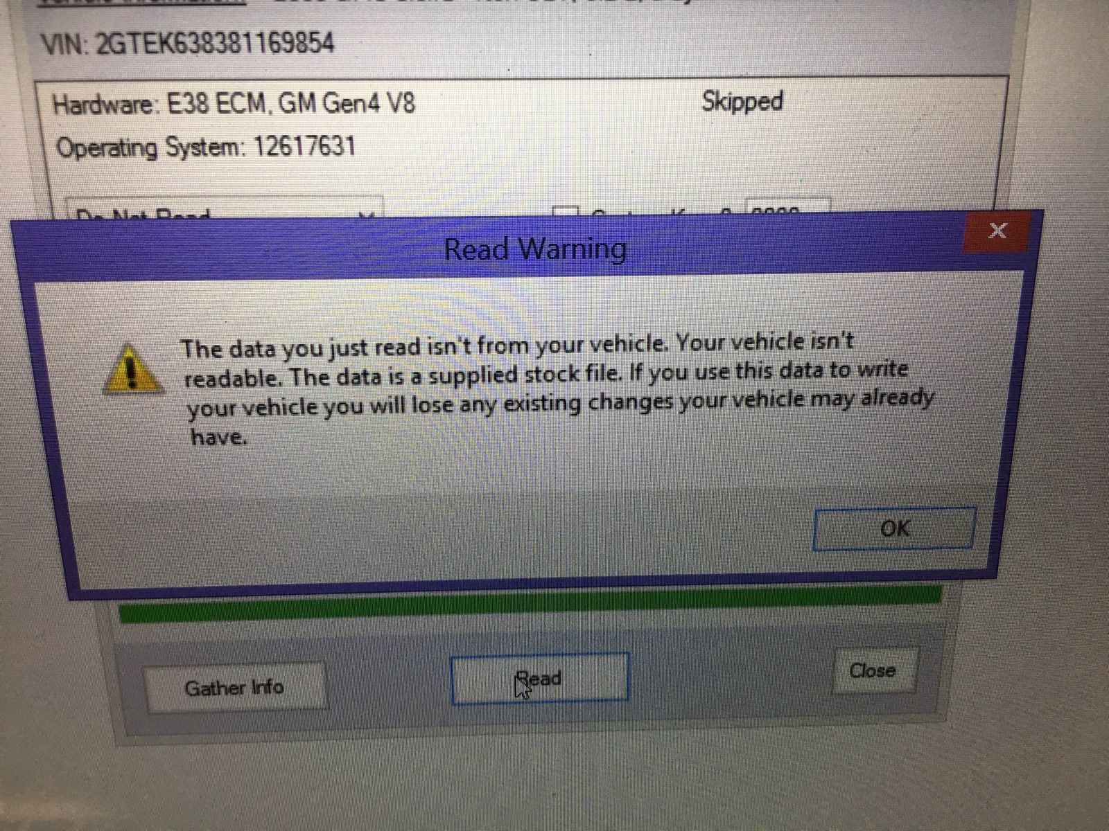

I read the other FPCM file and it didn't work. I think I'm doing something wrong though. I'm selecting do not read engine, do not read trans, and read FPCM. I'm getting the error message below.
I wrote back to HPT, hopefully they have some answers.
Doing a compare between an 08 (non-flex) and 2010 (flex), the low flow fuel pressure on the ECM side is the same (44 psi). Since I only changed the fuel pump, there has to be something going on with how the FPCM is running it. I'm going to do some logs to see what fuel pressure I'm getting in low flow conditions. I assume the closed loop control of the FPCM will make up for any variance though.
That is just a read warning. It's basically telling you it is reading the O/S and generating a stock file. If someone else wrote to it, you will never know what was written to it by reading from the FSCM via HPTuners. Select ok and it will read it.
