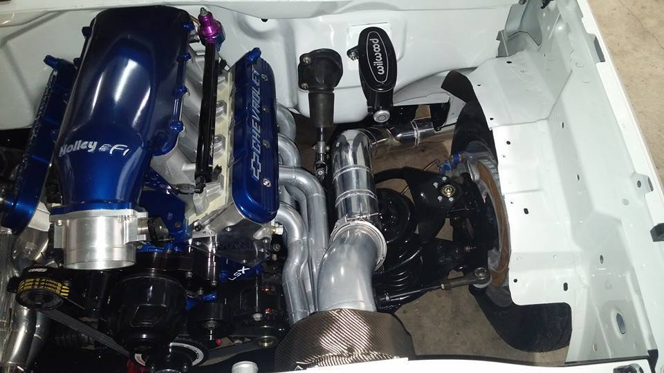

For those of you running the Holley Hi-ram, how do you have your regulator mounted and routed? I just got mine installed, and I do not like how the shop mounted and routed the regulator. Plus I need to fix the kinked return line that they installed:sigh: I was wanting to mount the regulator on the passenger side fuel rail and then run the return line under the intake, but I couldn't find an adapter fitting on Earls website that would seem to work. So...what did you all do? This is a NNBS converted to a return style fuel system to BTW :nod:

1 Attachment(s)
Attachment 90339
my old regulator setup, i used a union fitting

Originally Posted by George C.... (Post 5305262)
http://i948.photobucket.com/albums/a...pshna0w5gm.jpg
WOW! Looks clean.
TAPyvehc93 Aug 8, 2015 01:55 PM
What brand fitting?
George C.... Aug 8, 2015 02:40 PM
Magnafuel I do believe as it's purple
blown02408 Aug 8, 2015 06:16 PM
Mine is mounted similar to George's except on the front of the rail using an earl's -8 male orb to -8 male orb swivel, and there is also an aluminum bracket that runs from the regulator to the fuel rail mounting boss's to keep the regulator supported and keep it from spinning. Some pictures can be seen in my garage/album on here.
