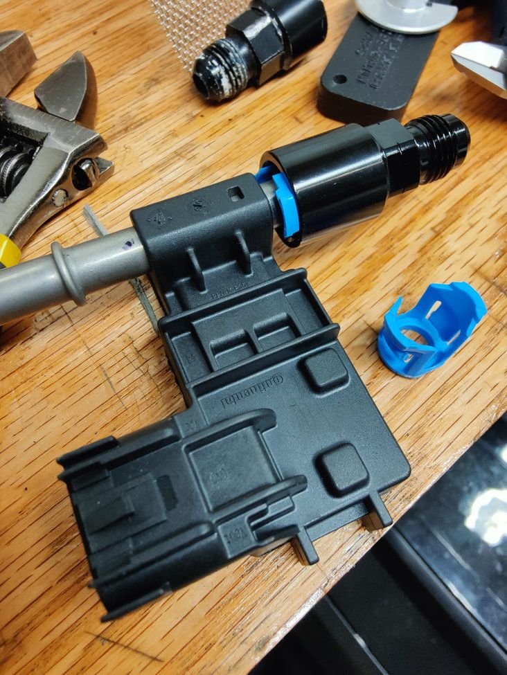

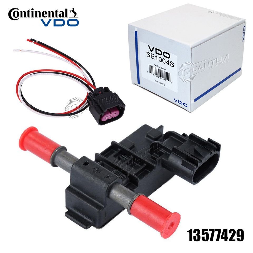

Don't i need flex fuel lines and seals ? will my pump and stuff be alright, it was not
rated for flex fuel from the factory.
is this the sensor i need ? i saw this being used.
Old Jun 30, 2023 | 05:04 PM
FFDP's Avatar
Joined: May 2014
Posts: 5,282
Likes: 599
From: Rogers, MN
No, you don't. These fuel systems use mostly steel lines from the tank up the engine bay. Ethanol has been in fuel since the early 2000's with E10 and E15 being a standard for the long while now. They have already made the lines and seals able to withstand it.
I've been running E85 for the past 4 years in my stock non flex fuel truck without issue.
Yes, that is the sensor you can use. I use that same one.
