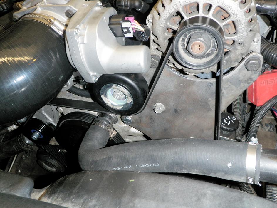

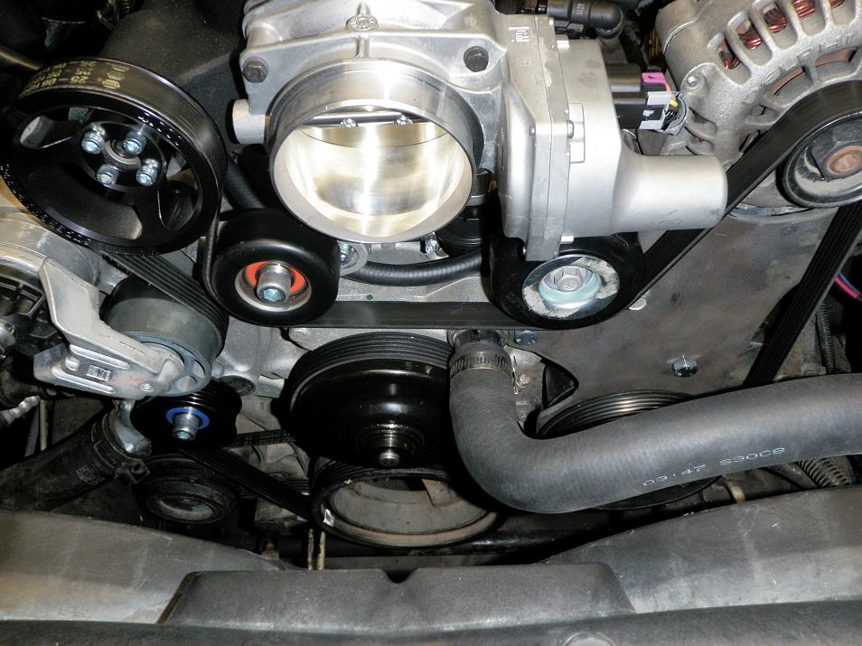

better pics
Attached Thumbnails Whipple 2.9L on a truck-p7100027.jpg   Whipple 2.9L on a truck-p7100028.jpg

Originally Posted by yurs78
This is exactly what I've been looking for, thank you so much for figuring it out!!! Please let us know what the results are.
How much compression is the engine? How big is big for your cam? Pump gas only or you gonna run meth?
Could you start the dyno as low as possible. I know this doesn't matter to many people (if any). But it's my main reason for FI (max power around 2000rpm) and I really wanted to know if this big of a compressor (on a 5.3) falls off hard towards idle.
Thank you very much for all your help, I can't wait to see what it puts down. Where do you think it will end up to the wheels, Do you think you'll see 500/500?
I am at 10.4:1, .624"/.624" 239/244 114LSA, no meth, not sure where it will end up. Don't really care, a z06 puts 360hp to the wheels on this chassis dyno so if its not generous by any means. doubt we will do any pulls below 2000rpm though, sorry.

Sorry fellas, no dyno results anytime soon. Had to tune on the road as there was something torn apart in the dyno bay. What I can tell you is that I am only hitting 6psi which isn't really a big surprise but I am able to run 20+ degrees timing in 100* ambient with no knock retard. I am ordering a smaller pulley tomorrow. Possibly track times next week if I get a pulley soon enough

Looks good, curious how it turns out with some more boost. What pulley is on it now?
Old 07-12-2012, 08:55 PM
snow white's Avatar
Join Date: Oct 2009
Location: Southern Alberta
Posts: 60
Received 0 Likes on 0 Posts
It has the 4" stock pulley now
