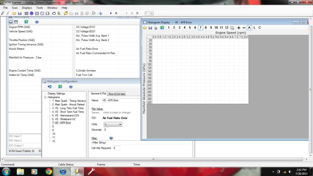

Try setting your histogram up like this. Except use a 2 bar map pid.
Thanks! i just left everything to defaults and it worked out great
