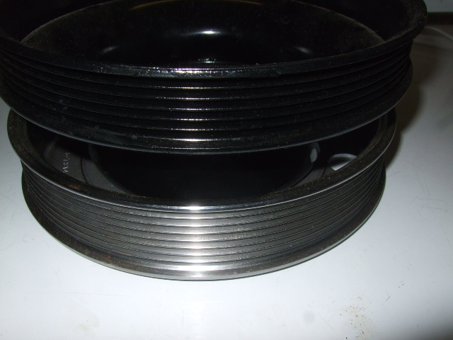

It looks like there is a lot of space between the A/C compressor pulley and the timing cover. I wonder if the stock pulley/balancer is cast iron (probably) or steel. If at least the outer ring is steel it might be possible to weld to it without damaging the elastomer dampening material.
Keeping the blower drive as close to the timing cover as possible will minimize the side-loading of the crankshaft. (That's what broke my 383 4340 forged crank.)
If you can get a pulley in between there and work out a belt path and a tensioner location, that would seem optimal to me.

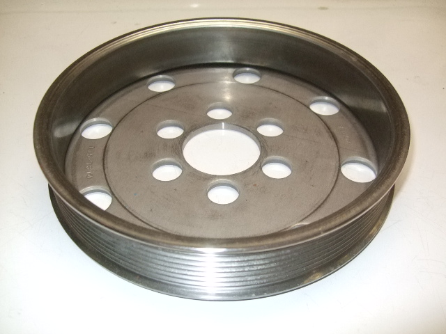

This is the pulley I had considered using:
The intent was cut out the center and weld it to the backside of the stock pulley.
