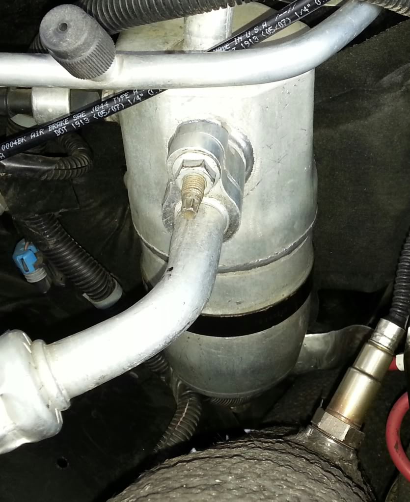

So I have been driving my truck a little. Very lightly, havent even gotten into the throttle at all. I stop and everything under the hood feels very hot. The AC drier actually looks bulged to me. When I stopped the truck it was reading 420, then cooled down to 320. Anybody else having this problem. I though it was far enough away from the DP. I couldn't imagine what it would get up to when I srart building boost.
http://i609.photobucket.com/albums/t...ps4ea6baf5.jpgAttachment 115202

I'd pull that wrap off, put a layer of ceramic fiber on the DP then rewrap it to hold it in place. It's not gonna get hot after that.
My turbo blankets were 1" ceramic and I could drive for hours, pop the hood and hold my hand on the exhaust housings.

Do you have a blanket on your turbo? You might think about putting that factory insulation back on the dryer. DEI makes the heat reflective tape that I wrapped my AC line and dryer insulation with. I could just be imagining things, but I think it made the AC blow cooler air.

That AC dryer does look weird.
Personally, I think my underhood temps were higher with my old SS 1 7/8" headers than with my current setup (DP wrapped in DEI Titanium and turbo blanket) on gasoline. But the underhood temps were still high. When I switched to E85 the underhood temps went way down.

Damn thats hot. Im amazed its even working. Normally that suckers a couple hundred degrees cooler than yours lol.

i have my DP double wrapped and a turbo blanket, never had any problems.

I do have a blanket on the turbo. Im going to have to look into that ceramic stuff, maybe I will even get the DP ceramic coated.

Here is what it was like right after I stopped driving. It is hard to see, but the laser is on the drier, not the DP.
Attachment 115200
Gadgetized May 31, 2013 07:14 PM
For some reason it never had the insulation on it that I see some trucks with.
