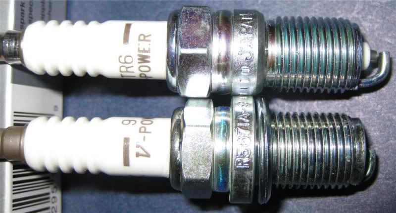

Here is a side by side of the NGK 9 beside the TR6
