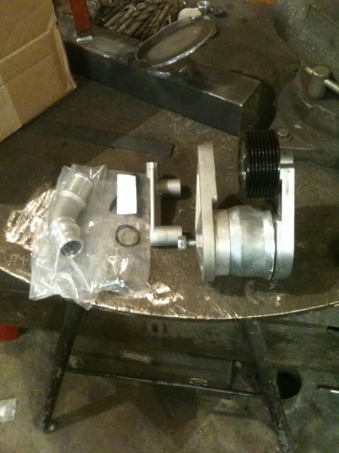

Got what I needed today. Special thanks to my little buddy!
need to see some pics of it installed now. i dont see why you need those othe lil parts but it will be cool to see pics of it all installed.

The only thing I don't think I'll need is the water neck, but it comes in the sub assemble that the spacer next to it that you do need is in. So I guess you get it any way.

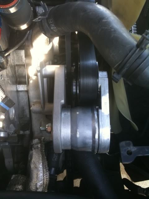

I got it from Magnuson. The sub assembly part numbers are...
31-12-00-082 upgrade radix tensioner
65-12-57-031 tensioner bracket
31-12-02-032 water neck replacement SSR (I didn't use the neck, but I think that's the sub assm that the 2 bolt spacer comes in)
Don't know that you lower boost guys really need this, but I'm pumping about 17psi out of this KB 2.8L
