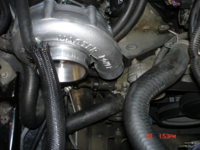

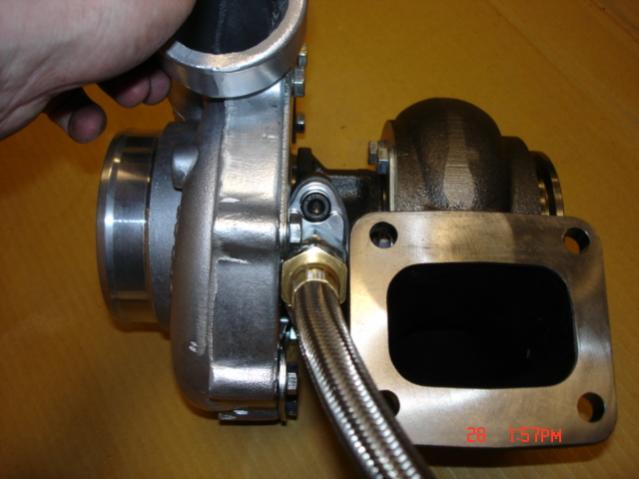

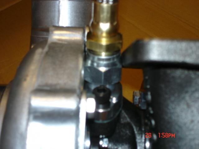

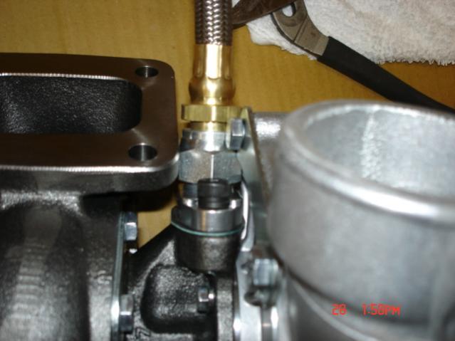

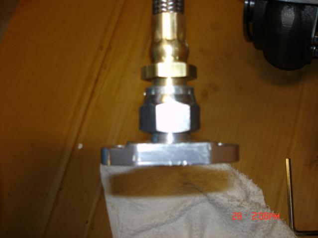

Well maybe I am over doing things and making this more difficult than it really should be. I tried to run a #10 line for the oil return. I got an aluminum flange off ebay, and had a line made up to go on the fitting. Had a hard time lining everything up on the bench but it fit with everything lined up properly. Today I started to put everything on(havent had time to work on this thing lately), and I can't clock the cold side of the turbo to where I need it. One of the bolts that goes into the cold side of the turbo hits the fitting, not letting me clock the cold side a little more clockwise that I need. I already had to swap the hold down flanges around on the cold side to clear where the fitting is at.
Any ideas? Should I just try going to a #8 line? The only reason that I went with a #10 was so that the oil would be able to flow better in the extreme cold. What do you guys think?

Make a flange for the return and weld a stand pipe on it with a -10 fitting.

I used industrial pipe (nipples, coupling, and 45deg elbow to angle my -10 drain fitting to where I could access it best
