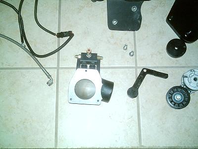

Ok heres everything. I had to use my 4 year old $100 Walmart camera because I cant find the upload cord for my brand new fancy camera.
Notice on the intake deal with the 2 injectors in it is a little hook up/ nozzle.....thats for nitrous but was told it was never actually sprayed through. Hope hope hope this shiat works.

You will need:
-New water neck assem. for the water pump as this cant be removed once installed
-EGR relocation bracket if you stay emissions legal
-Wires for the throttle body if you can remove them from the harness then they aren't needed. THey need to be lengthed for the new postion of TB.
-New gasket for the TB from a 8.1 liter TB.
Thats all i see that you need and that should cover it since this is a single belt setup. They require less parts for the install. If you need help installing it just shoot me a pm or i can give you my cell phone number and i can walk you through it. OR if you have any questions feel free.

You will also have to do a search on how to set the bypass up since your not using the whipple cpu.

yours looks like an older kit, the injectors are now put on the rear of the supercharger.

Yeah thats the new kit you have. Its there so called intercooler/chemical intercooler where they spray into the supercharger. His kit isnt that old because they just came out with the kit you have.

the kits are the same except for the location of the injectors, and yours probally came with a different tuner
