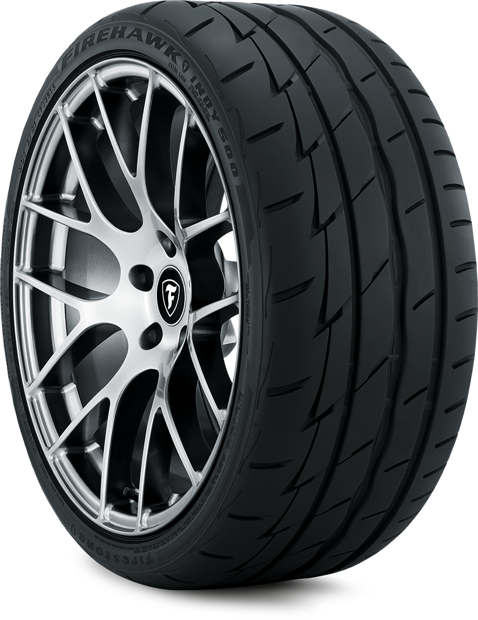

I was looking at the 275/40r20 Firehawk Indy 500 for street duty (I really need to replace posi and gear before I try a sticky tire on a sticky surface).
