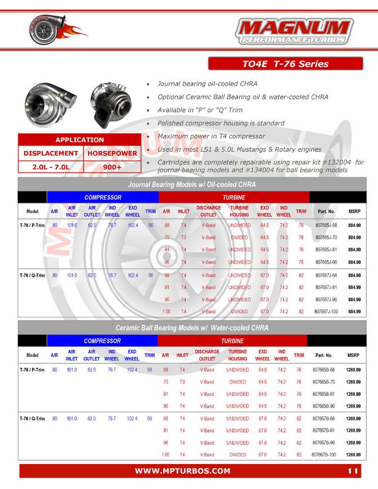

Id go either a BW S475, or 476R/87 with 1.25 AR T4. Should make a ton of power. It will be a little laggy on the 4.8 but the n2o should fix that. It will be a beast on the 5.3. Another option would be run the smaller .90 or 1.0 AR on the 4.8 and just by another housing when you swap engines.

Even if he turns the boost down and sprays instead, the exhaust side is still too small! N2O will make more exhaust gasses as well. That 67.0/74.2mm exhaust wheel is very small for that power level.
