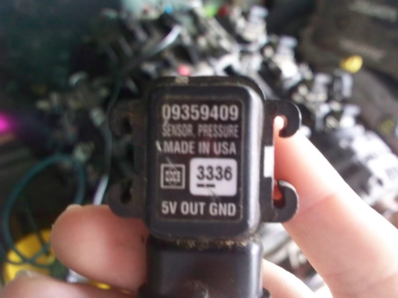

03supercharged Mar 31, 2010 12:30 PM
2 Attachment(s)
Ok I snapped two quick pics
This is the one on my truck manifold
Attachment 141881
This is the one that came off of a cobalt SS
Attachment 141882
According to the part number its a 2 bar, does that mean the motor I bought from the junkyard had some mods to it?

kbracing96 Mar 31, 2010 10:45 PM
1 Attachment(s)
Sorry man, but the both of the ones you have are 1 bar... Here is a pic of a stock 1 bar on the left and the Ion Redline 2 bar that is what everyone uses for 2 bar direct replacement.
BTW, the 2 bar MAP PN 12580698 is now superseded with 12615136 according to gmpartsdirect.com ;)
Attachment 141883
03supercharged Mar 31, 2010 11:09 PM
Thank you! I just called my buddy that gave me the cobalt sensor and he said he gave me the wrong one, Im getting the right one tomorrow from him :)
