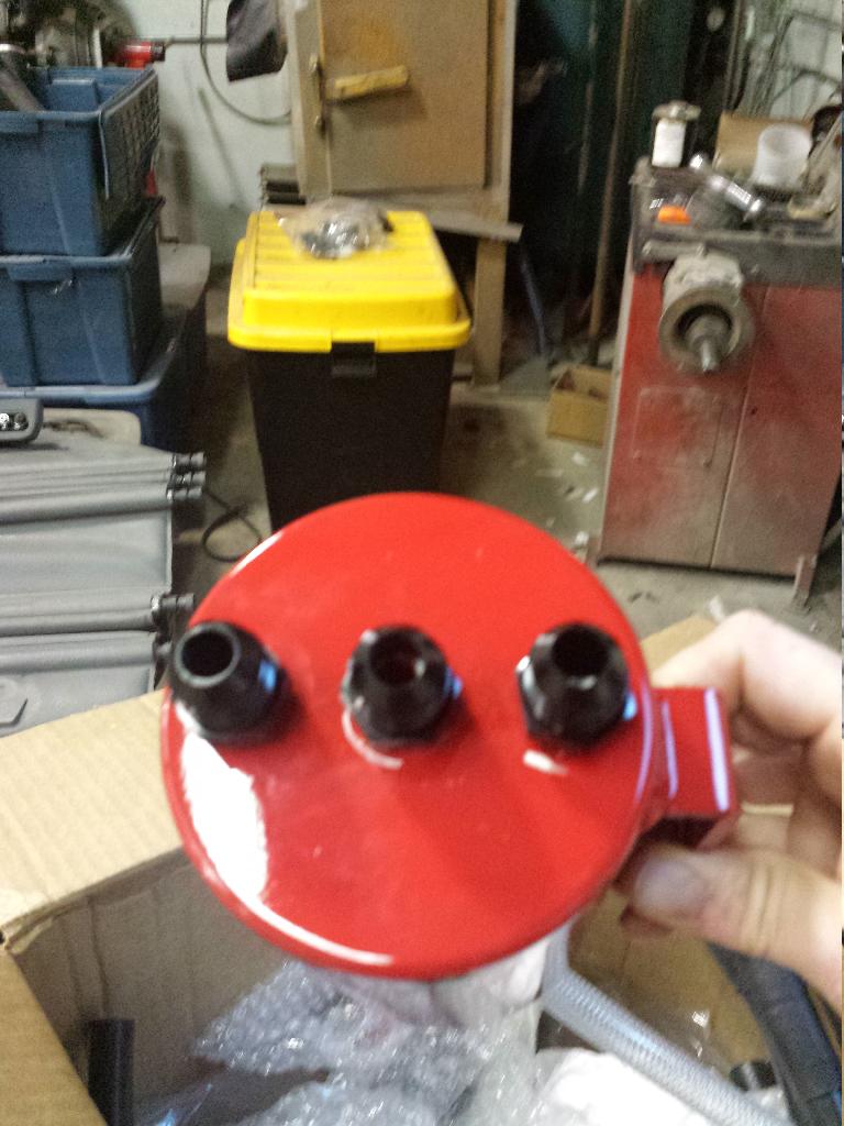

blownescalade62 Dec 6, 2013 11:27 AM
4 Attachment(s)
Here are some pictures for you.
Attachment 108134
Attachment 108135http://img.photobucket.com/albums/v2...206_085039.jpgAttachment 108136Attachment 108137
Denali08 Dec 7, 2013 12:11 AM
http://img.photobucket.com/albums/v2...206_085056.jpg
[URL=http://s.photobucket.com/user/240FOWLR/media/Mobile%20Uploads/20131206_085046.jpg.html]http://img.photobucket.com/albums/v2...206_085046.jpg
Did it come with the hoses or you had to order them separately?
Is the the 2nd pic for oil file cap or a valve cover vent? Ok, I take it back, I can see the fill cap cover underneath the big red filter with hose barb.
How do you plan to connect the larger hoses to the engine? It will need AN fittings and probably some cutting and welding to fit them.
blownescalade62 Dec 7, 2013 12:37 AM
It came with hoses. I will just reduce to connect to engine. That is a RX billet 1LE style clean side separator in question ordered that separate.
Denali08 Dec 7, 2013 02:02 AM
1 Attachment(s)
You mean this one?
Attachment 108073
blownescalade62 Dec 7, 2013 10:14 AM
Yes correct
Denali08 Dec 8, 2013 03:48 AM
Originally Posted by blownescalade62 (Post 5169722)
Yes correct
Does it have a filter inside it or it's only an adapter fitting for connecting the hose?
My fill cap is very close to the S480 that I had to remove the fill neck and put back stock cap directly to the valve cover. There will be no room for exept a nipple fitting on the cap
