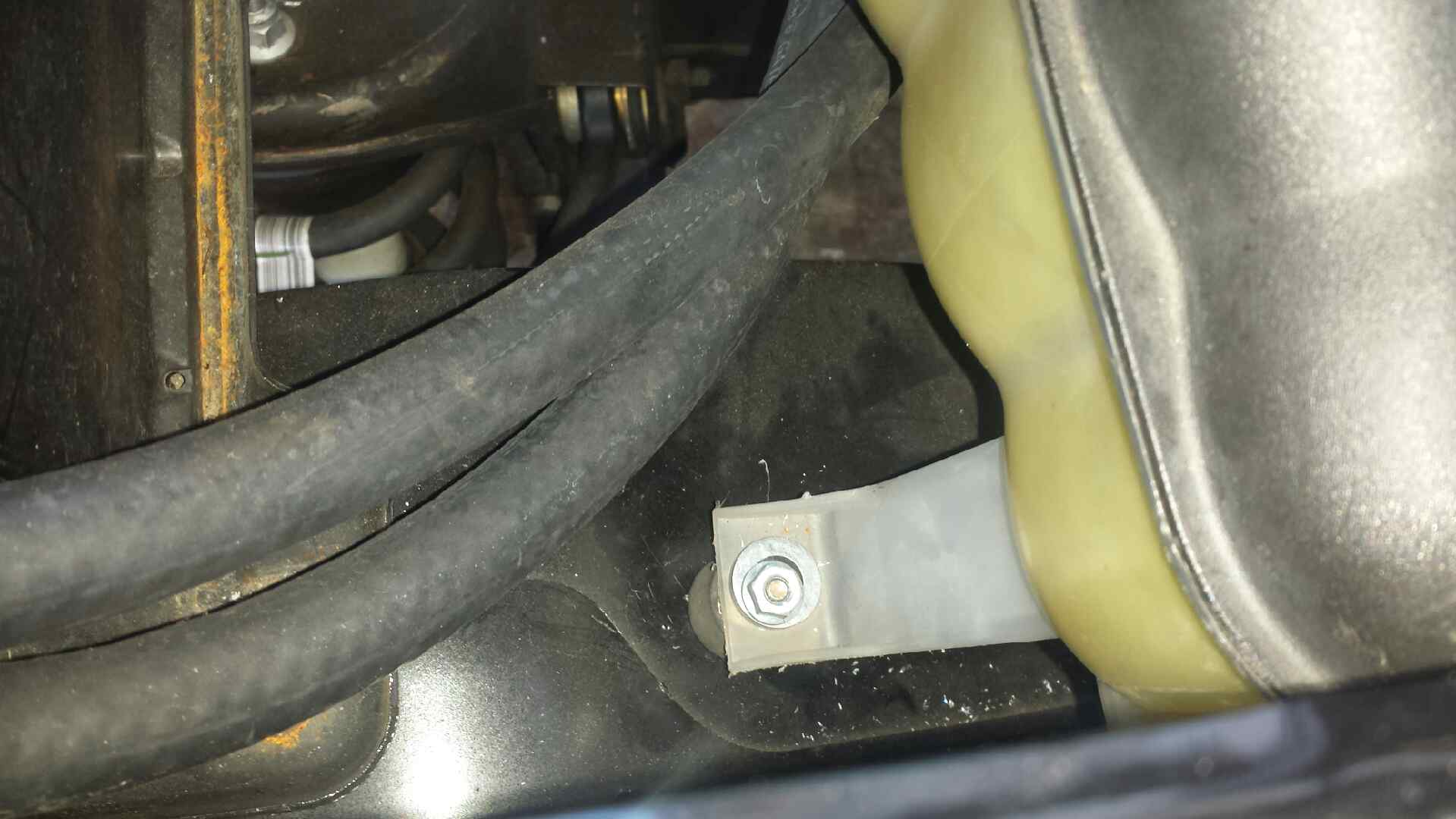

Guys I working little by little to get the truck going. Waiting on some stuff with Trick Turbo to get the oil feed and drain done. Also having to relocate the knock sensors. The old style iron block didn't have them on the side of the block. Drilled one hole on drive side to mount one and install pass side in one of the pan bolts. If anyone has a ideal to relocate coolant tank I need ideas.

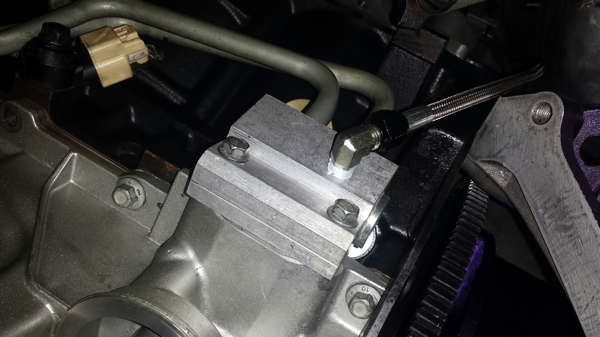

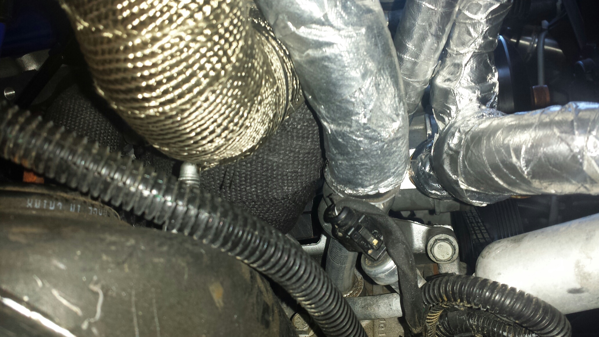

Well get close. All done on the bottom. Drilled a hole in the oil cooler adapter and install fitting for turbo feed. install crossover with the nice studs Trick Turbo sent. And painted turbo housing. Next Im working on reinstalling the turbo and do drain line and downpipe. 6.2 turbo build-20141023_191933.jpeg

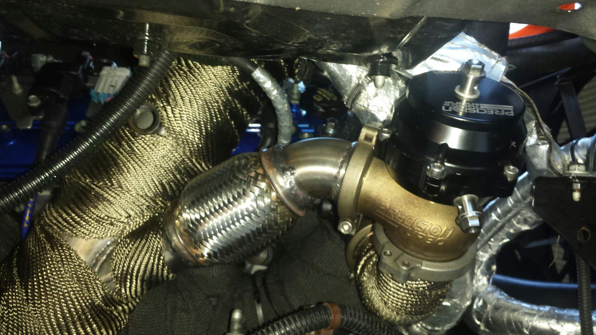

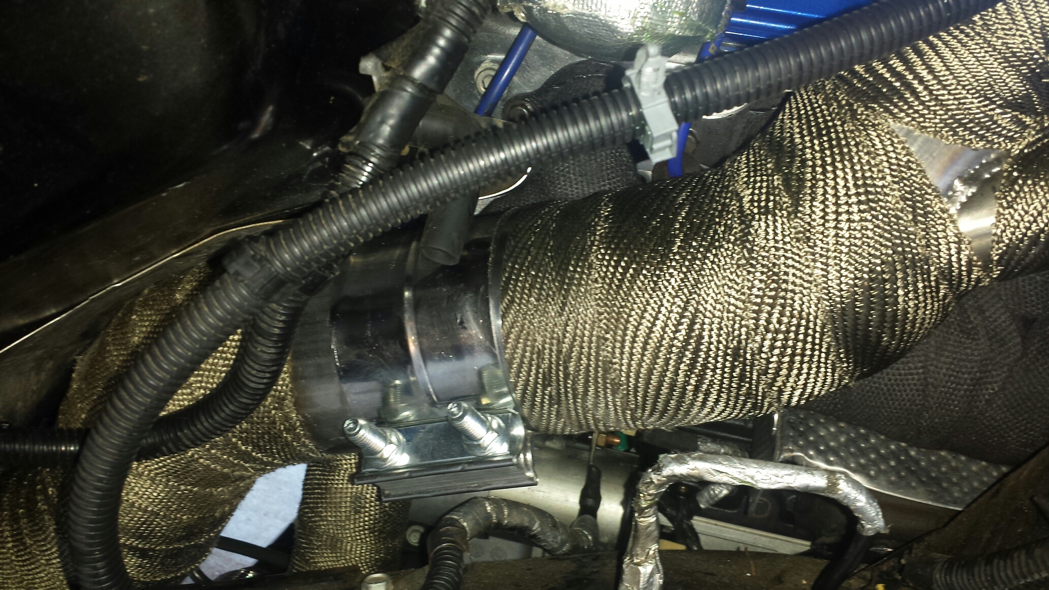

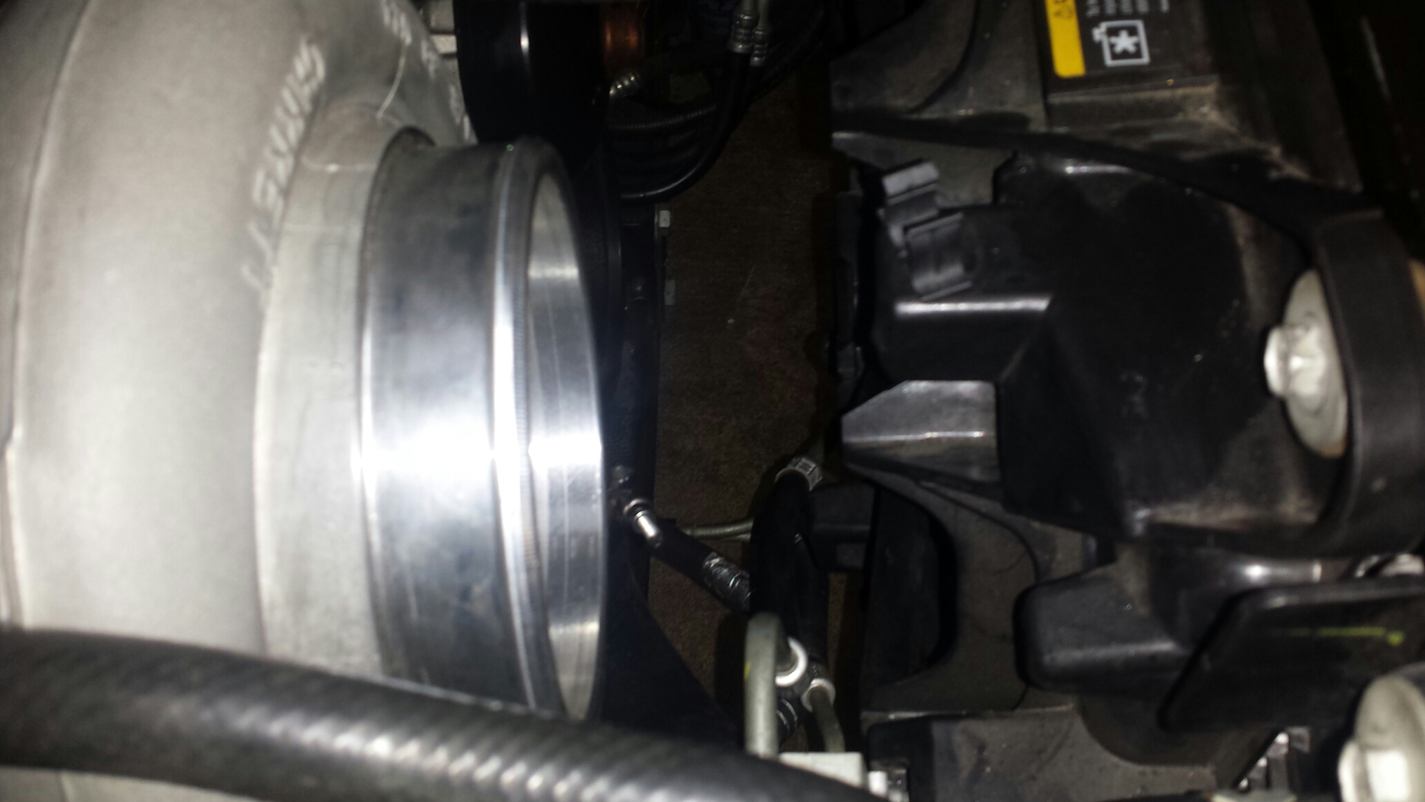

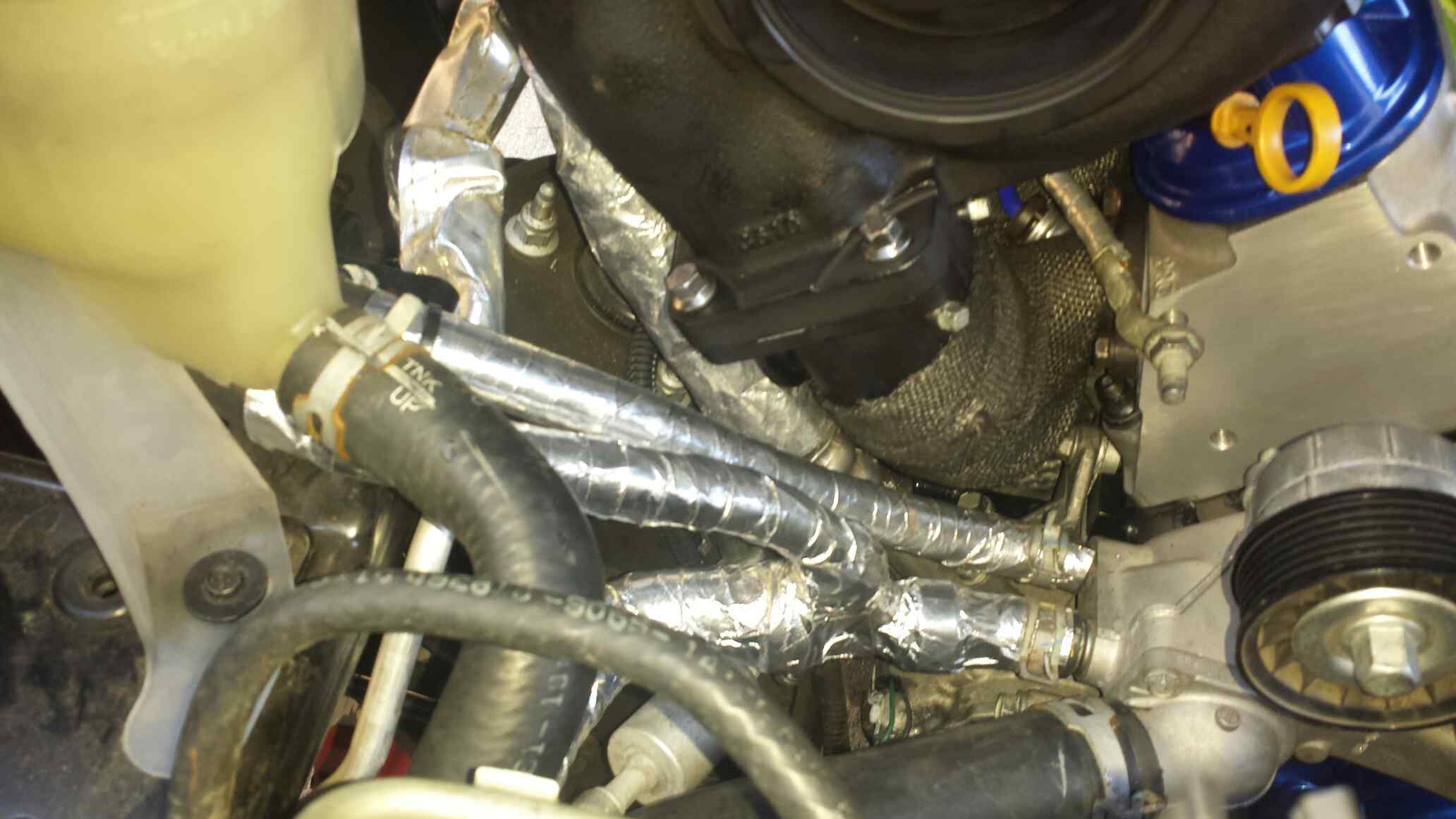

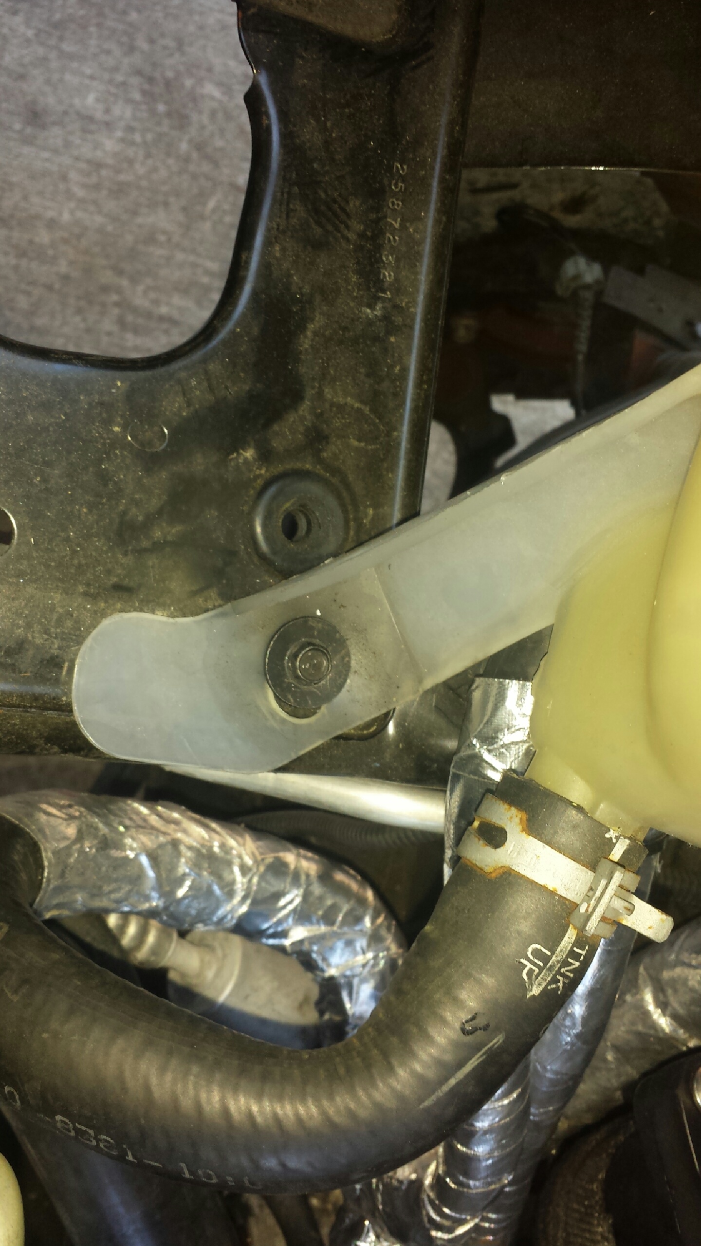

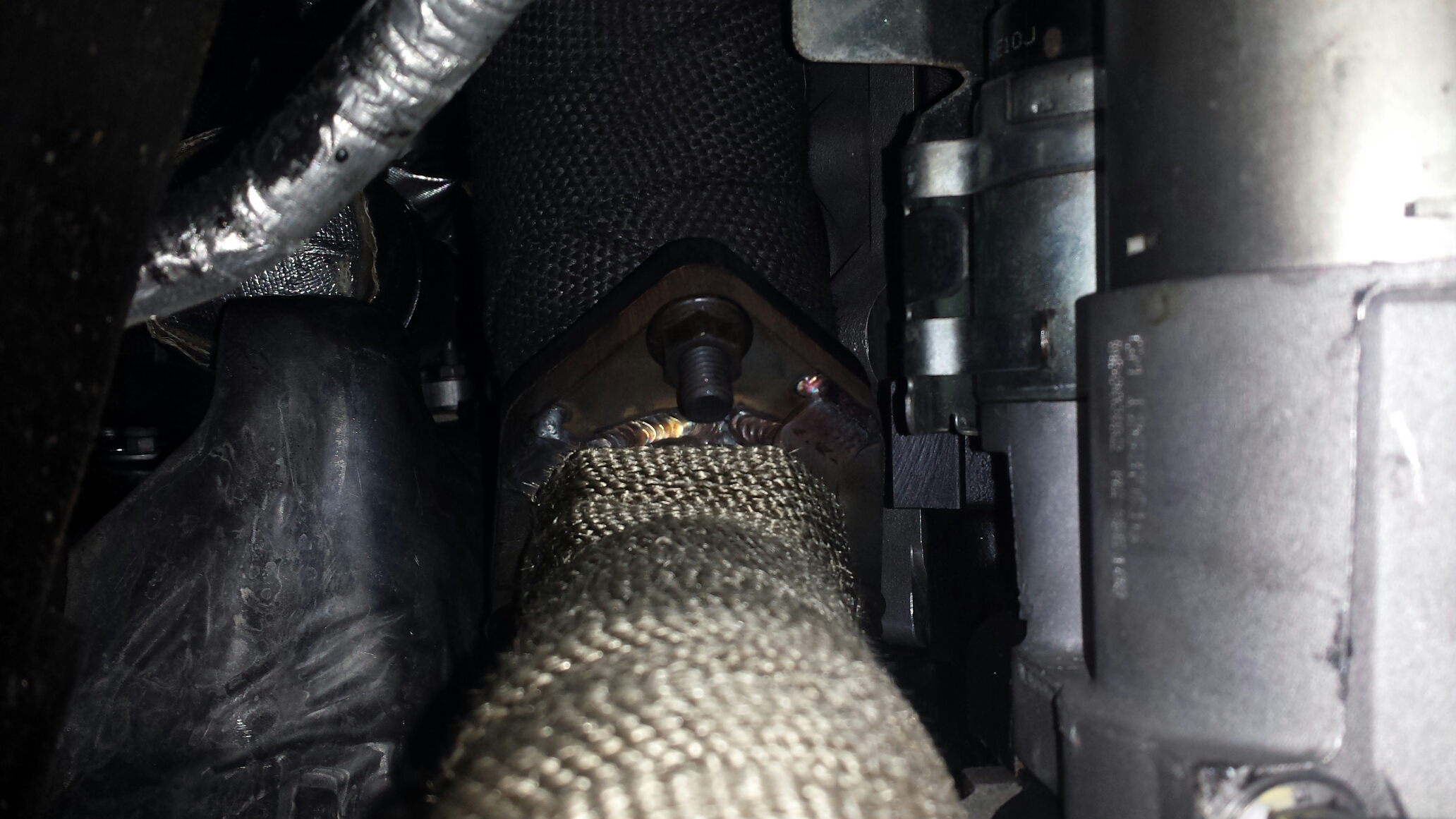

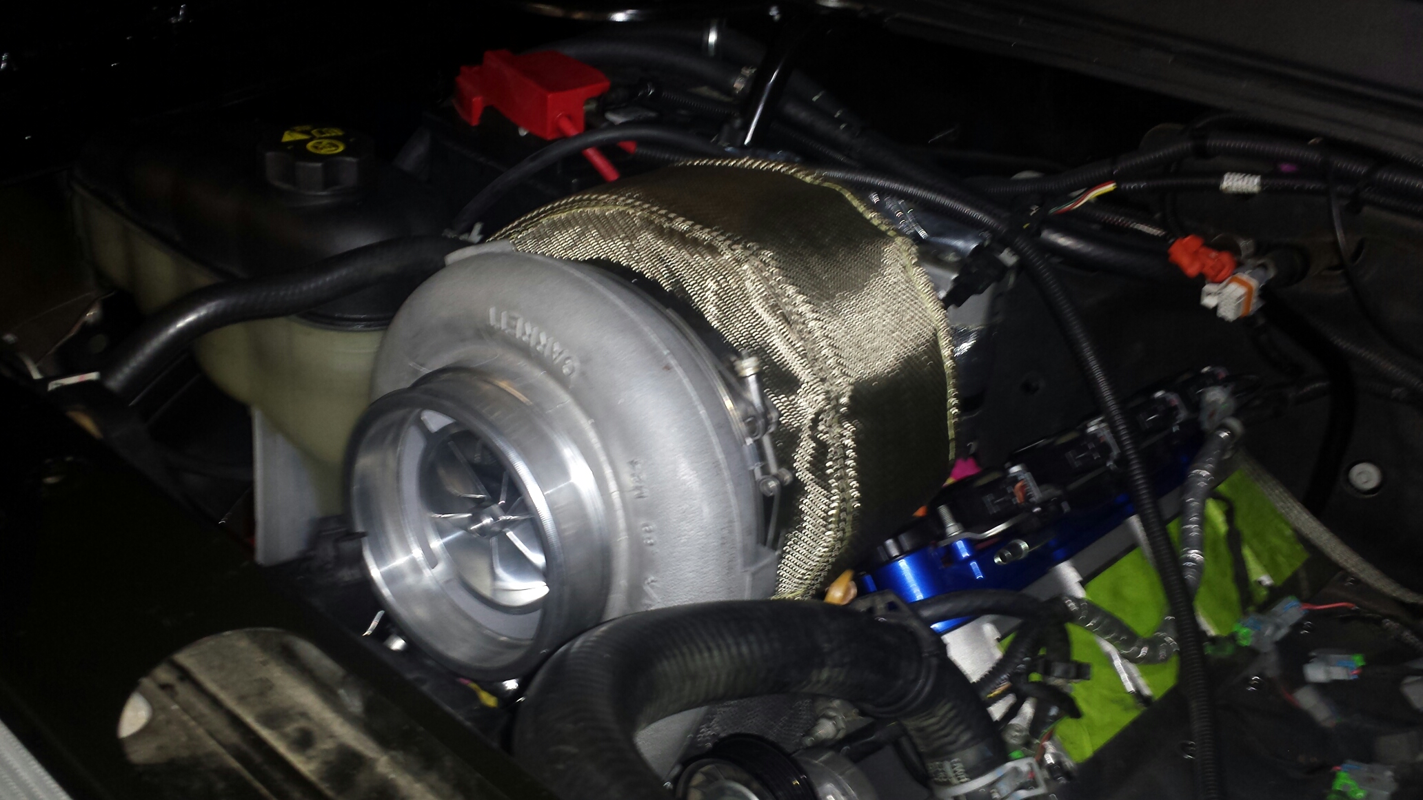

6.2 turbo build-20141025_202705.jpeg Been work hard on the Beast. What you think so far. Still needing to redo the lowside a/c line it works but I want it away fron the turbo. Next i will do boost controller to the gate. Install intake, injectors, alternator and belt. Plus the oil feed on the turbo should be here first of the week. Oh I ordered 4in tubing to build a custom exhaust. The muffler is still up in the air.
