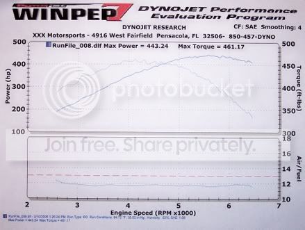

This is as big as I could get them to post.

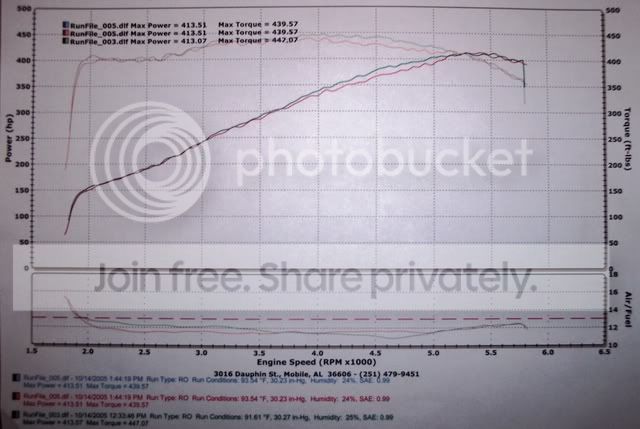

Am I reading them wrong or is your torque curve really messed up?? You were making 400lb ft at just before 2K rpms before and now it doesnt get there until almost 4K and after that it falls off very quickly!! That sure LOOKS like something isnt right to me.
Previously at 5500 you were still making 400lb ft, now at 5500 you are only making 350rwtq. Somethings up

The torque is scaled different than the Hp. It autoscales this way. Be sure you guys are looking at the torque scale on the right side.
It was hovering around 80 degrees all day in the shop. On a blower car/truck, the correction factor only corrects so much. I've done blower setups on Cold days and then on Hot days and the corrected number is always higher on a cold day. This isn't as much of an issue on a NA application, but on a boosted app it plays a big role.
The converter cost you some power, but you are still ahead. The headers are for sure needed. It will only intake so much air if it can't get it out of the engine. It is a pump, in order to get more in, it has to have a way to get it out.

That makes a big difference LOL! Nobody I showed them to has noticed the other scale. Maybe the scale is messing with my head. I KNOW the 6L is making more Tq than the 5.3 did. But the numbers aren't there. But there is a big SOTP difference between the 5.3L and 6L on low end Tq. That's why I was so surprised that adding more boost and leaning it out didn't feel stronger.
