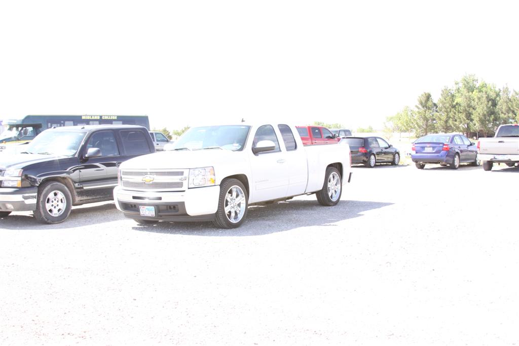

OK GUYS HERE ARE PICS OF THE TRUCK WITH THE HARRIS SPEED WORKS PLATE KIT ITS ONLY HARD MOUNTED FOR NOW SHOULD BE WIRED THIS WEEKEND RAN OUT OF TIME THIS PAST WEEKEND....HOPING TO HIT IT WITH A 100 SHOT NOTHING CRAZY....WILL POST MORE RESULTS AS THEY COME..

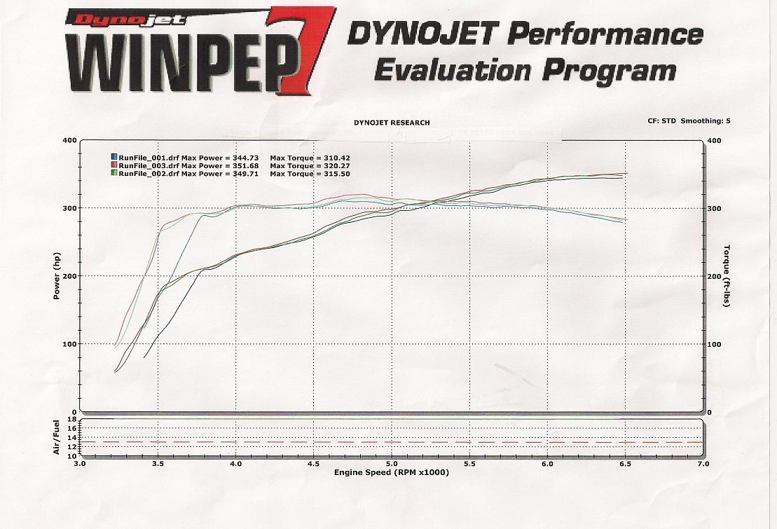

Ok guys SDPC has been working on our 2010 silverado 5.3 upgrades are listed below with the dyno sheet....
heads ( stock) w/ls6 springs
stock bottom end
dod delete
pacesetter long tubes
off-road y-pipe
fast 102mm truck intake stock t/b
powerbond underdrive pulley
kn cold air intake
tuned
magnaflow cat back
vvt comp cam custom grind 218/222 .560/.566 lift 115lsa
dyno is on 22" wheels

Not bad for a 5.3 and 22s but a bit disappointing when you compare this dyno sheet to a 6.2 dyno sheet. Don't get me wrong the 351hp 320tq is respectable but cam headers and the work to be swapping lifters and the money alone for all these mods I would rather find me a used 6.2 and swap it out and make the same numbers with a stock motor and still have all the potential to make more power.

We are not working with a 6.2 let alone with an entire engine swap. Customers have shown great interest in what they can do with a mild cam 5.3 and that is what we are working with. This is a project to gain more HP out of the incredibly common 5.3 while also maintaining the advantages of having VVT

Oh and I was gonna ask how much of an increase are you seeing vvt cam swap only and do you have others then the one you used?

We are figuring about a 40 hp gain on just the cam to the wheels. As for grinds i can do just about what ever you have in mind all i have to do is call a custom grind is really no more than a off shelf grind...
