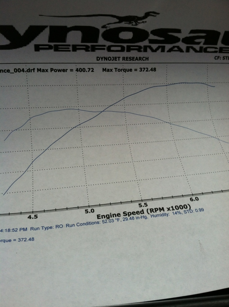

Put the truck on the dyno after the swap from cam 5.3 to h/c/i 6.0
Attachment 122293
Attachment 122294
Video is 2nd gear pull. Truck kept going into REP trying to day a 3rd gear pull. It did manage to make 388tq in 3rd gear @5000rpm but then would fault into rep. TB and Xlink issues I really havent pinpointed yet
2nd gear unlocked dyno pull - YouTube
04 LQ4, FBO, nnbs intake-TB, ported 799's and EPS 222/226 597/605 112+4

That is a STRONG 6.0. I wouldn't be surprised if you saw 420-430 in a 3rd gear pull.

Where did you dyno the truck at?
TXSZ66AVLANCHE Jan 17, 2013 08:22 PM
Note to self....look at the dyno sheet

Wish I could see the sheet. Its not popping up at work.
