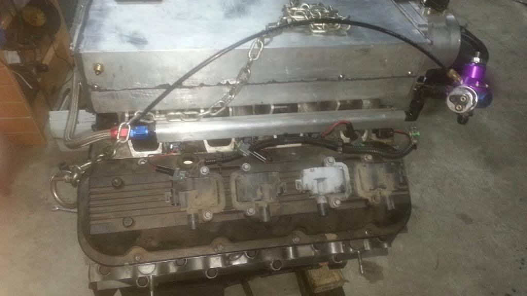

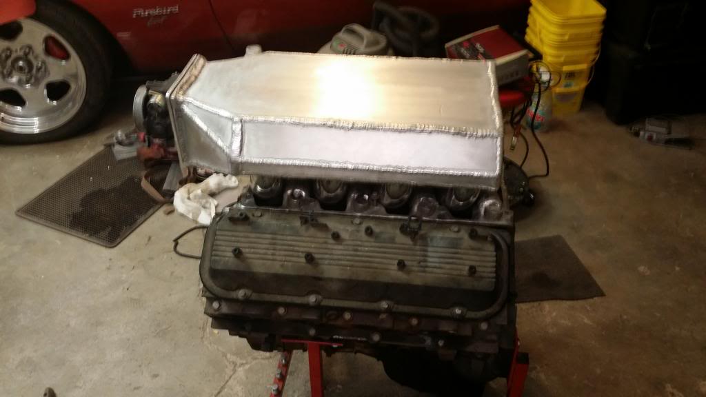

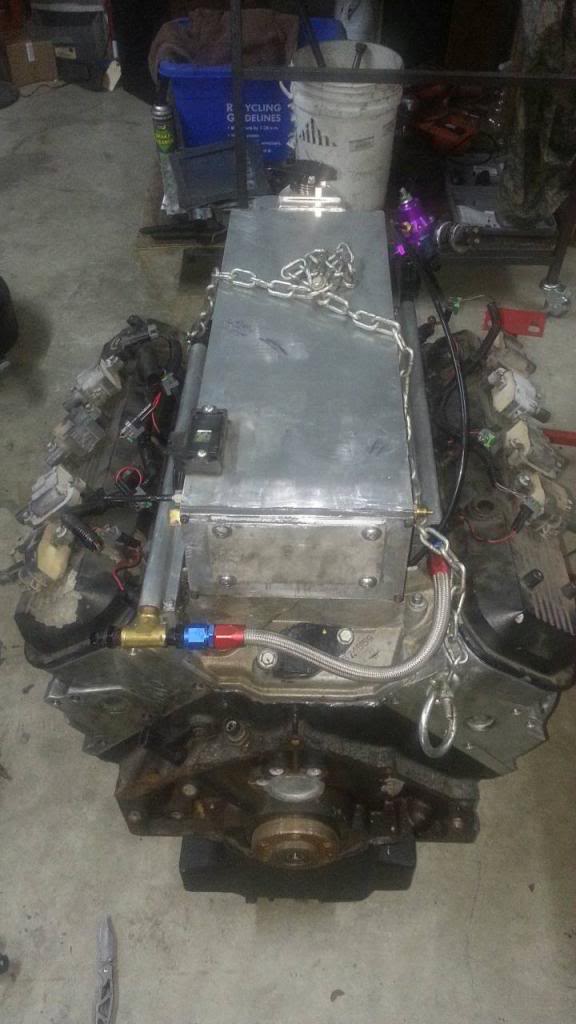

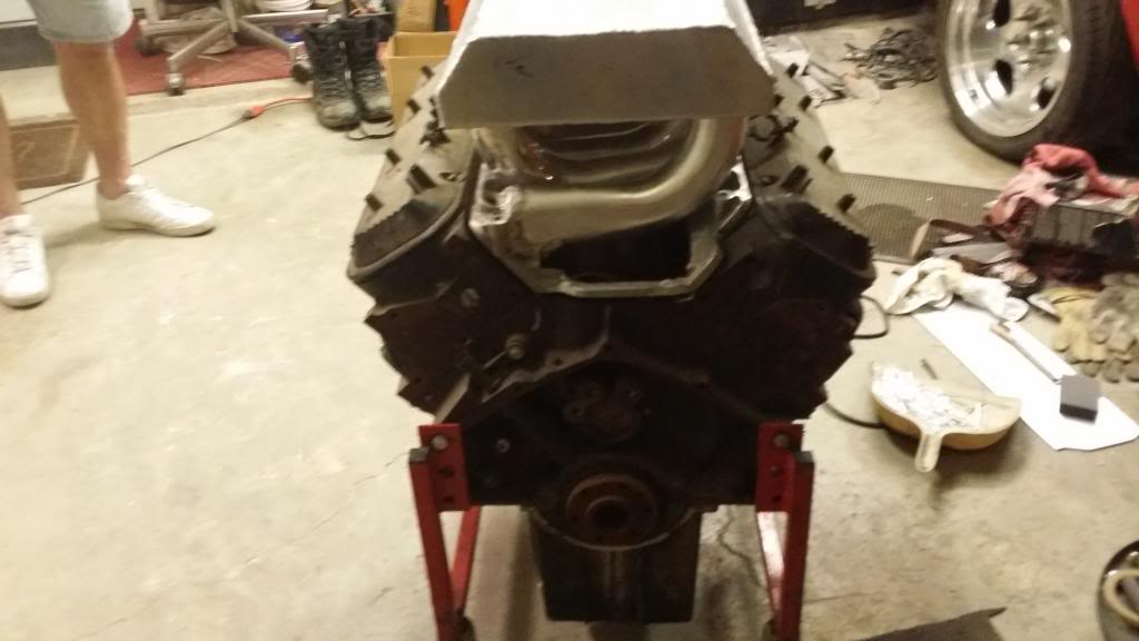

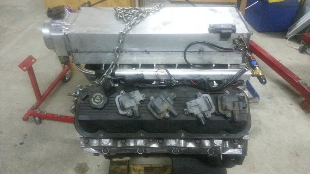

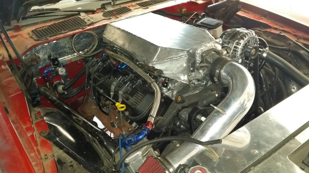

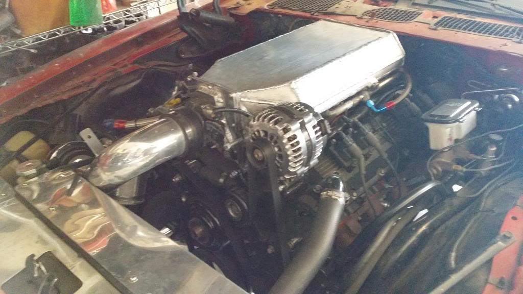

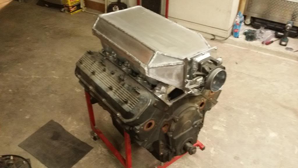

Are you fabbing it from scratch or using a stock intake modified? Me and my buddy made our own plus i own a raylar one

yeah i did short runners when dyno compared to the raylar, the long runners of the raylar made more power n/a. I have not done a boosted comparison. mainly because it is such a pita to swap in my 1500's

also make sure you account for the ac bracket or alternator, me and my buddy both had to modify things to get stuff to fit
