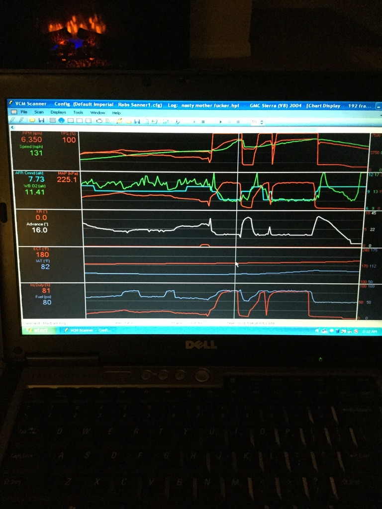

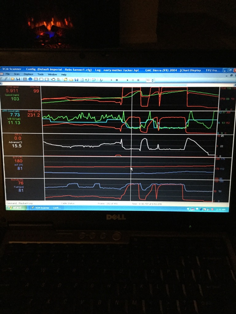

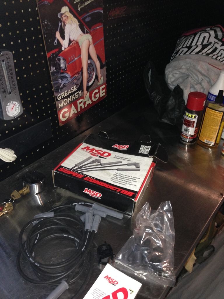

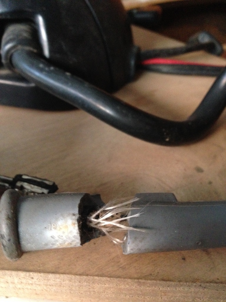

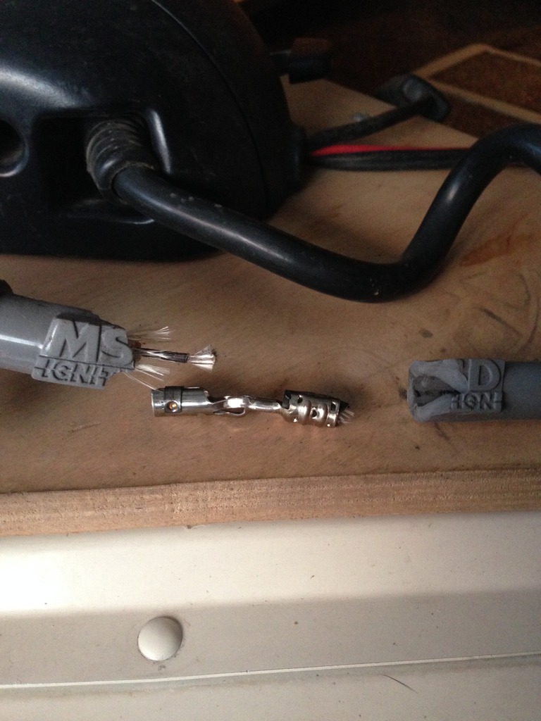

What happens when you don't drive anything with pep for 6 Months? Everything feels fast.. Red had a few boxer motor sounds lately going to work and breaking up some under boost, figured tune was just a little off.. Well while she was boxering tonight I started pulling plugs to troubleshoot. You even arc bruh? Was hooking in second above 60 on 7 candles.. Now she's back to inhailing the tires in 3rd starting at 100 on all 8 candles... "Someone found their top end" -Adam Sander voice. =) coming for y'all Mr 383 Z.. Now time to try a set of those 315 pro radials by Mr Mickey.
