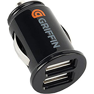

On both vehicles I left two items plugged in all the time. Both were 12v to 5v converters rated at 2A.
In my quest to locate the drain I asked some electrical types if chargers like these with nothing connected would drain. The told me no. I told them they had small indicator LED's. I was told it would be miniscule.
Long story short they were wrong. One was like the shown below. It ate up 40mA with nothing plugged in. The other was similar but of another MFG and ran up 22mA with nothing connected.
The were both made to charge phones by converting 12v to 5v @2A max. They both had LED indicators.

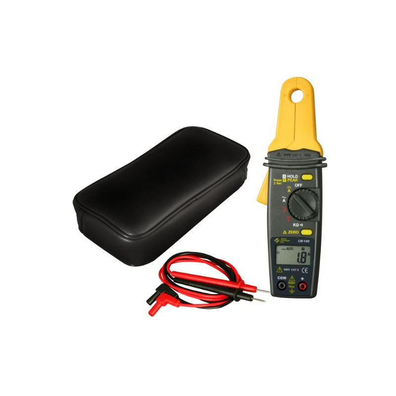

What helped me find it was a great little meter (GTC CM100) at a great price point $143.00 shipped from Amason. See it below. If interested read ALL the reviews. There are some skills and tips particular to the unit and about the DC amp clamp world as well. A good U-Tube review is also available if you look.

I pulled fuses and plugged and unplugged every thing I could and when I got to these on each vehicle it told the tale. My drain dropped to just below the 50mA recommended maximum.

I wanted to add an FYI on how this little adapter will pull .020mA with nothing attached.

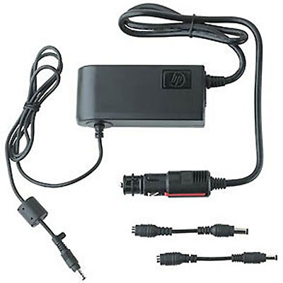

The biggest drain I had was my laptop car power 12v DC adapter. It was not consistent because I did not always have it connected.
The HP Pavilion DV6000t 394159-001 adapter has an output rated spec of 19v @4.62A. Don't ask me how it does it from a 12v source but............
Anyways with the DC meter clamped on I inserted it into the 12v accessory socket today without the laptop. The drain increased by .250 mA !!
So there were times I was pulling .375mA with the key out. Ouch!
