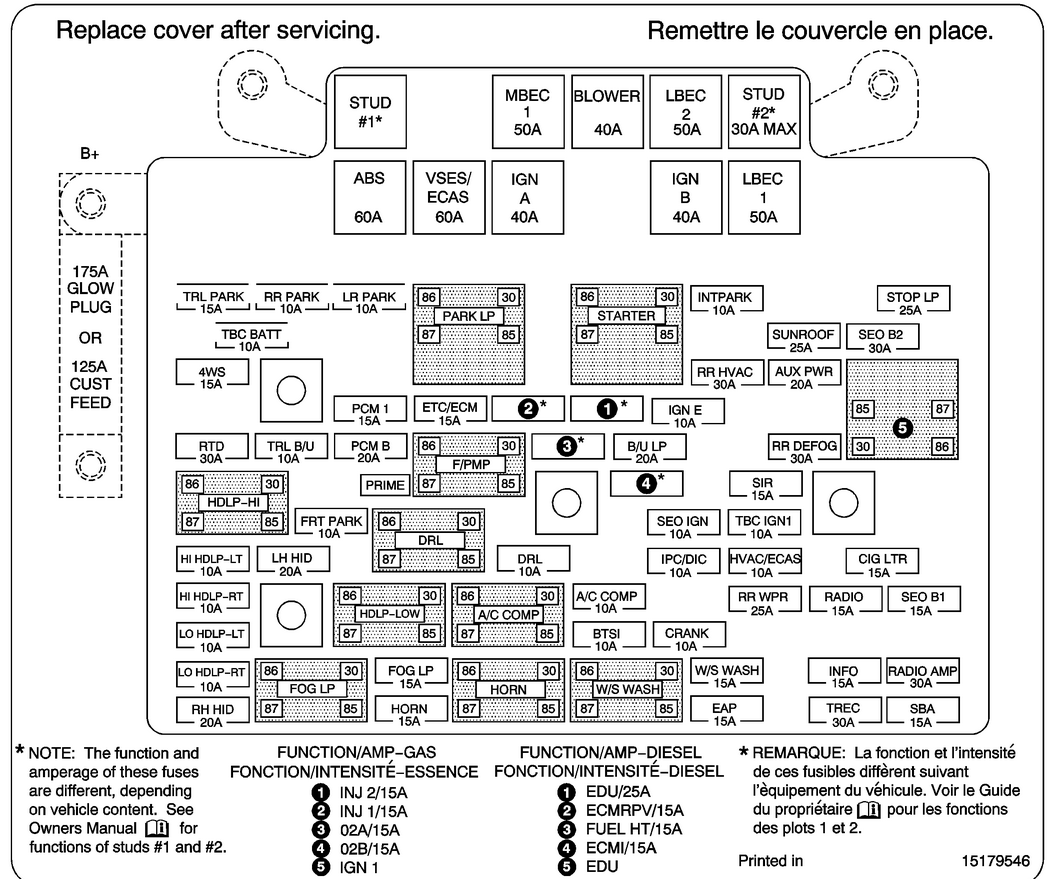

Duramax 175A Megafuse glow plug fuse.
https://www.carid.com/merchant-autom...mpn-10316.html
bad parasitic load - Diesel Place : Chevrolet and GMC Diesel Truck Forums

Although after researching it seems the lowest amp you can get those fuses is 100a... seems like overkill for one amp... maybe my idea isn't as good as I thought.

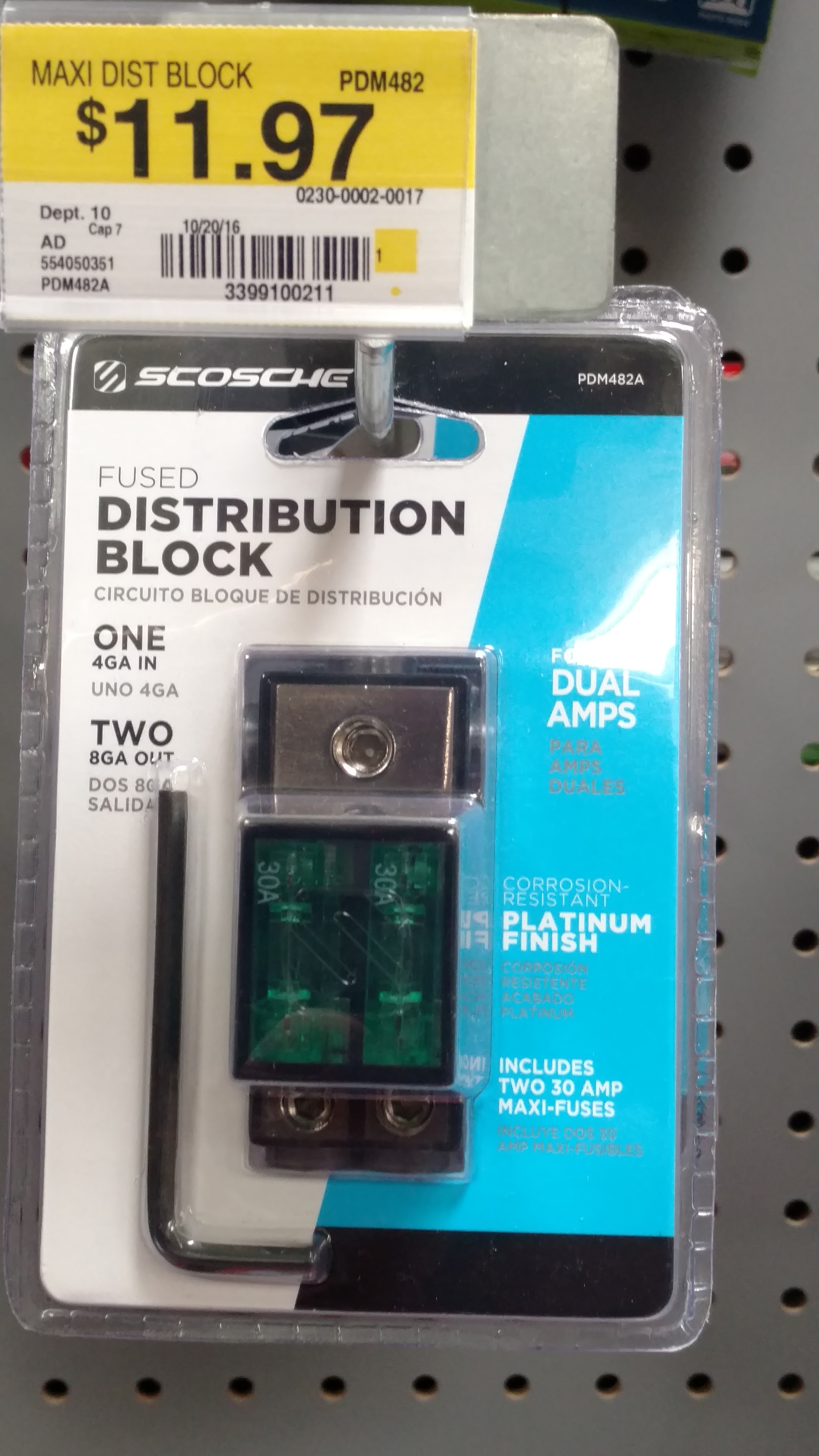

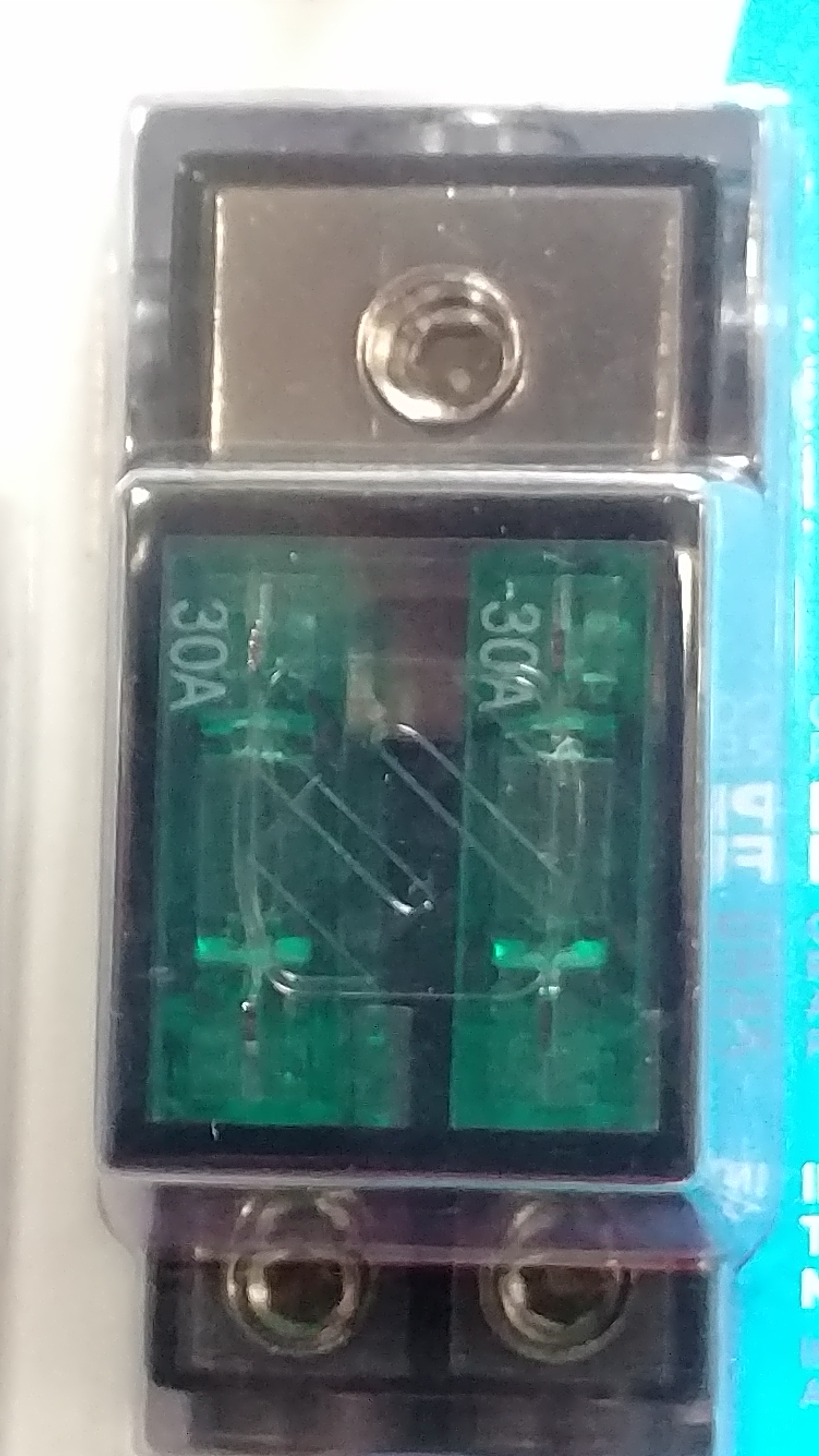

I saw this at Walmart today.
Attached Thumbnails Anyone familiar with gmt800 fuse block?-img_20161115_130052101.jpg   Anyone familiar with gmt800 fuse block?-img_20161115_130101400.jpg
Old 11-15-2016, 10:12 PM
GM1697's Avatar
Join Date: Oct 2014
Location: in MA or SC
Posts: 1,568
Received 12 Likes on 8 Posts
Thats pretty cool and not too expensive...
