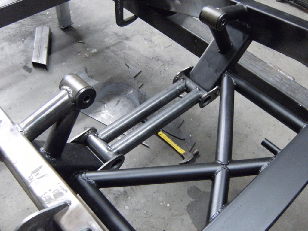

Wanted to add a gusset for the upper link mounts
Finished up the lower link mounts
Had to bend and weld them together
Welded them up and added a gusset

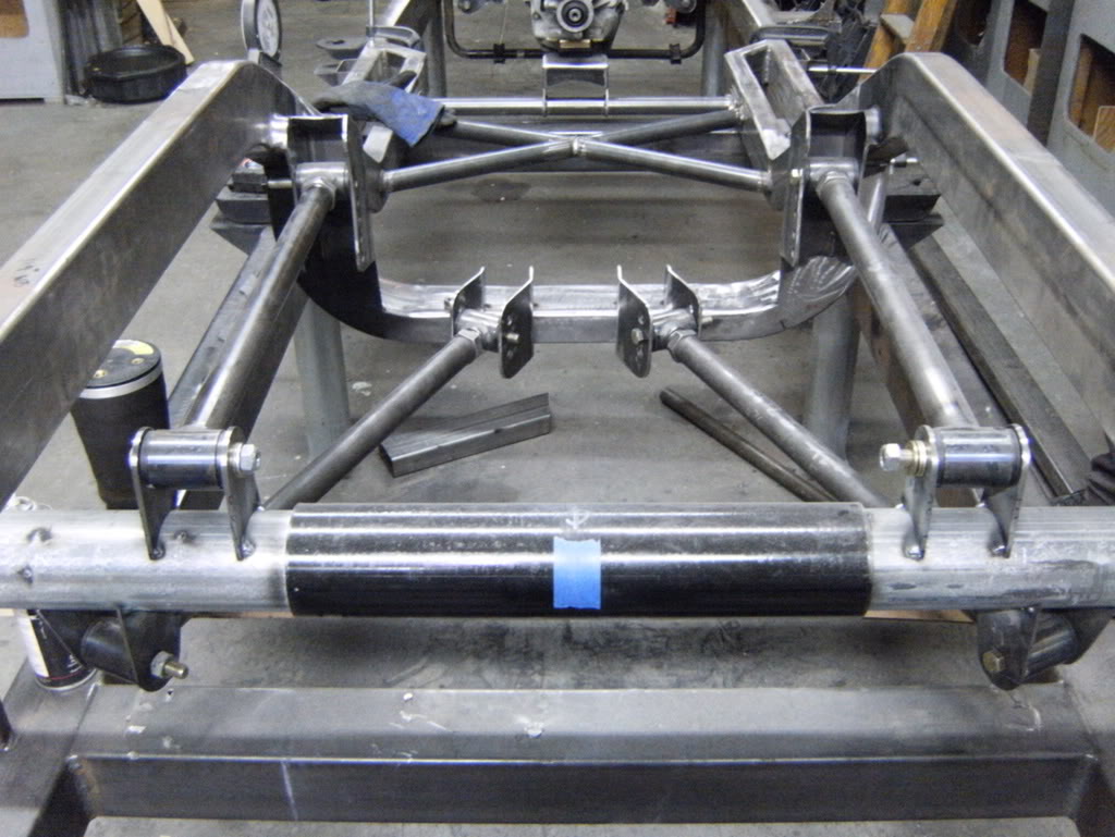

Finally designed and made my under engine bolt in crossmember
