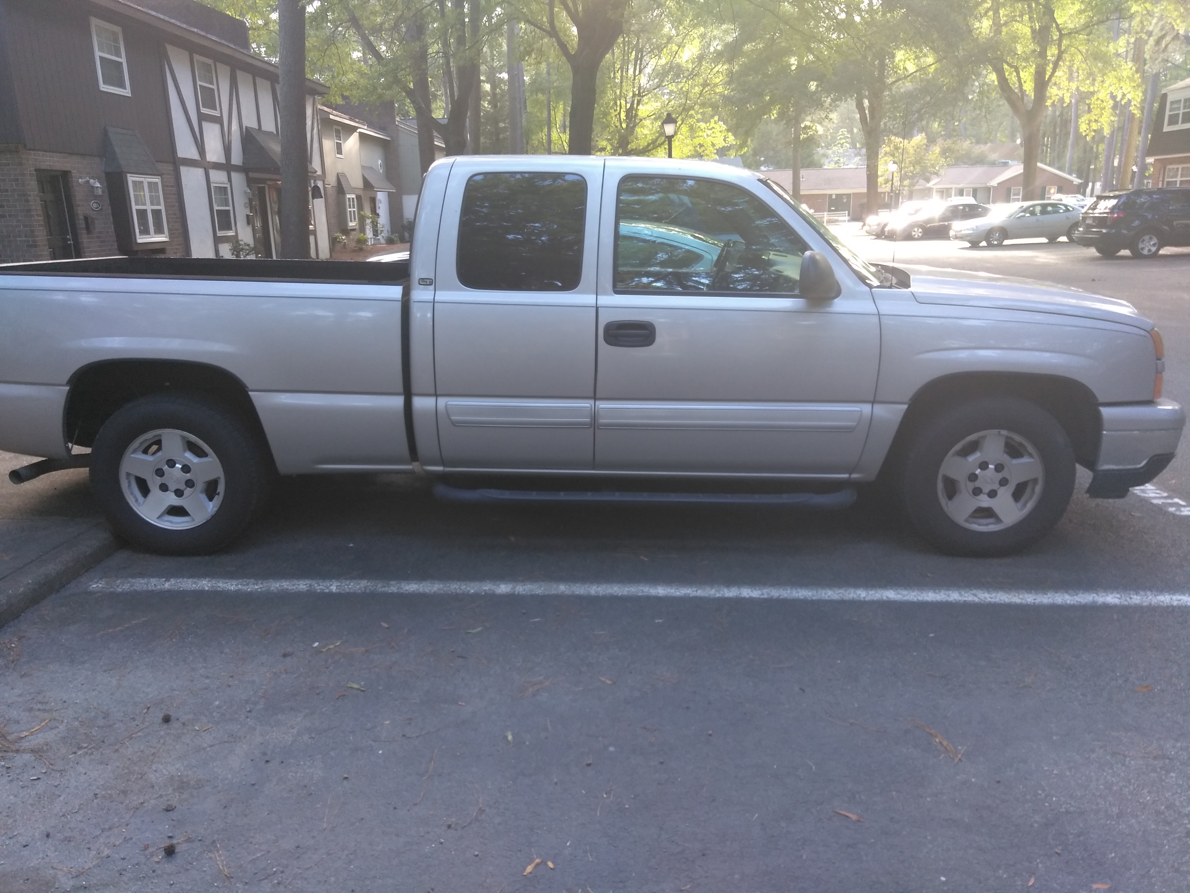

Default Want to lower
I've got a 06 ext cab silver I want to go with a 3/5 on 275/45R22s but if I can get away with a 4/6 on same wheels and tires without rubbing or having problems going over speed bumps I would go with that. Any idea or pictures would help a lot.

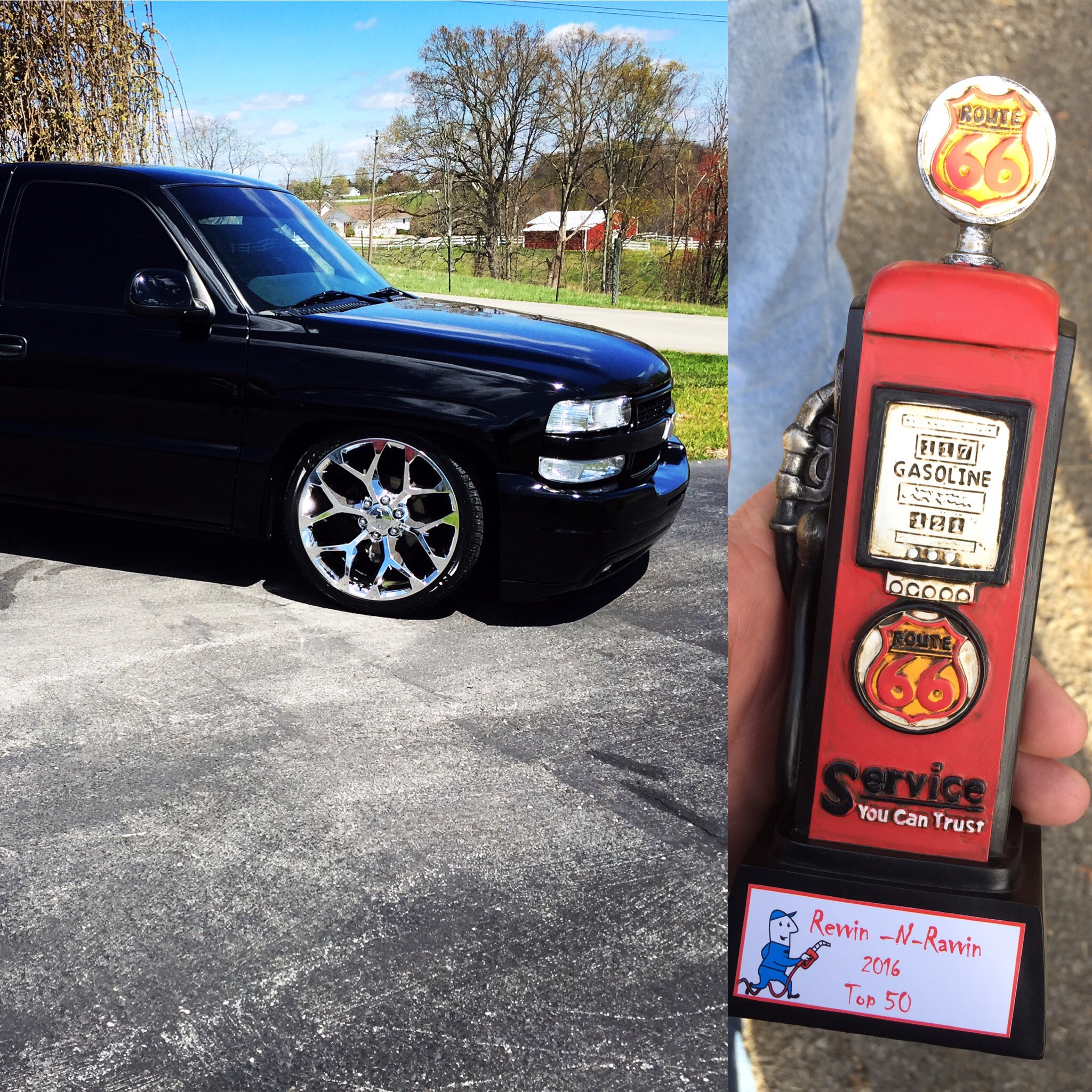

Default 2000 Silverado 5/7 22's
I have my 00 Silverado lowered 5/7 and I am running 22's 265/35/22 all around and I have a very little rub at full turn or when hitting bumps but one way I stopped that was by installing a set of rubber spacers in the springs and eliminated 99% of my rub....and still measures out the same as far as the height of the truck......

Nice Little truck you got there! Those wheels were made for it....
