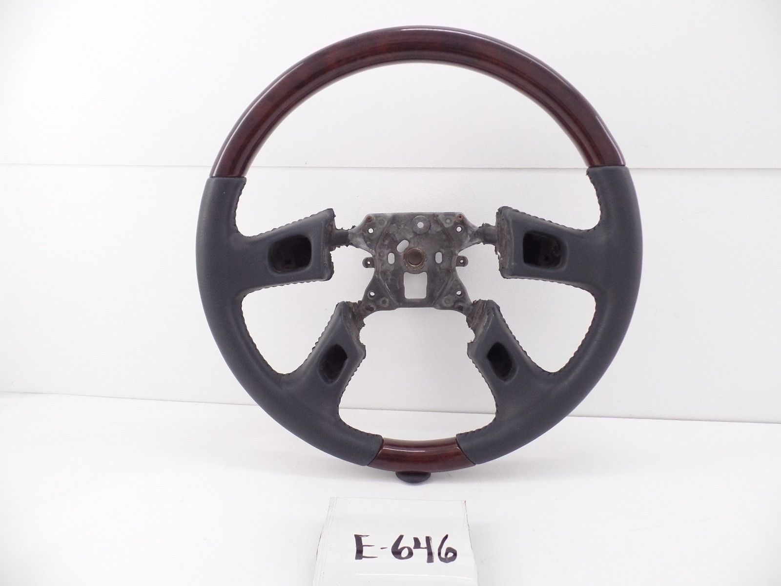

As mentioned by others the headliner is cake to remove, you could recover it your self if you have the time. As for the interior swap, the 99-02 steering wheel will also be different as the steering wheel controls will no longer useful that came on your truck. As for the door panels, they will fit but the 03+ panels fasten to the doors bit differently using large push fastener in front of the panel, and a screw in the back of the panel ( back being closest to the door jamb ) also the master switch on the drivers side door and pass. Door use a different door harness/connector and will not work. You would have to install the door panel and use your trucks window switches..... they also fasten a bit differently then the 99-02 ( which uses tension springs ) 03+ is fastened to the door panel with screws from " the inside "
Which means that the window switches stay with door panel and need to be removed after the panel is off the door

Thanks for the information on the panel differences, which is why I'm opting for the paint route. On the steering wheel subject, can I swap may airbag guts over to this wheel.........
Old 02-26-2017, 07:08 PM
11 Second Club
MrHorsepowerLSx's Avatar
Join Date: Mar 2011
Location: NJ
Posts: 850
Received 30 Likes on 30 Posts
Yes you should be able too
