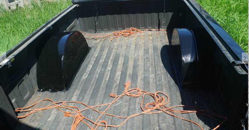

Wheel tubs pretty much done
All I have to do is seam sealer and line x the tubs.
I'm not sure yet if I'm going to step notch the frame yet depends on the ride height.
