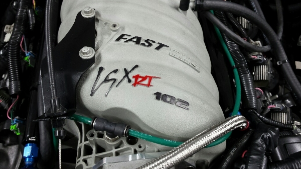

i took a 2003 Tahoe 4.8 engine, added a z06 vette cam, pac1218 springs, new head gaskets, arp head studs, a Fast lsxrt 102mm truck intake, holley fuel rails, 80lb injectors, snow performance stage 2 meth kit, all stainless braided -an fuel lines and fittings, a vette regulator/filter combo set for 58psi, aeromotive 340 pump in the tank, and bolted everything up to my 4l80e and billet 3400 converter. all exhaust will be 4" back to axle.

the intake..
