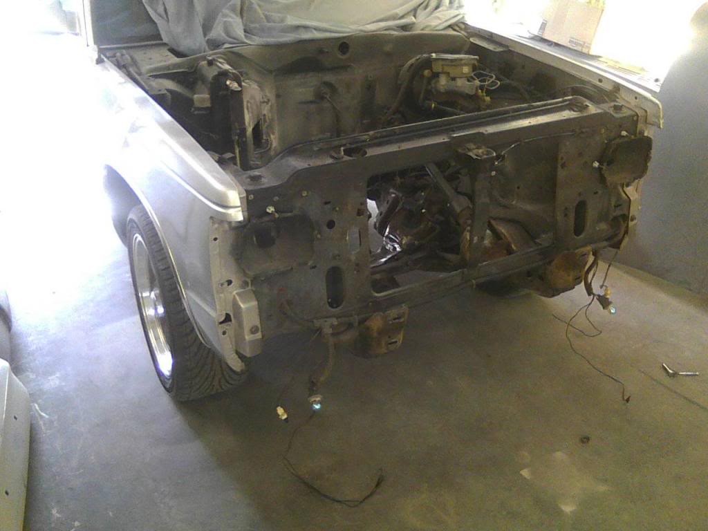

Don't laugh but when I loaded it to go to the body shop to have firewall and fender wells painted I put the wheels on the wrong side. I felt like such a dumbass lol

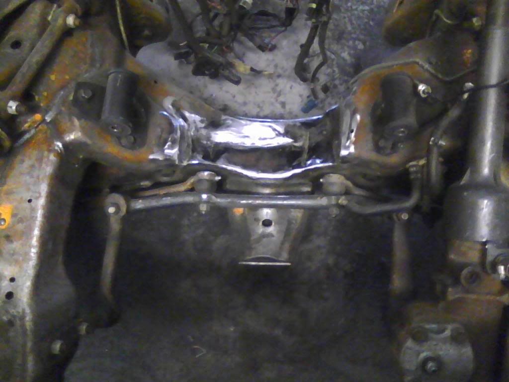

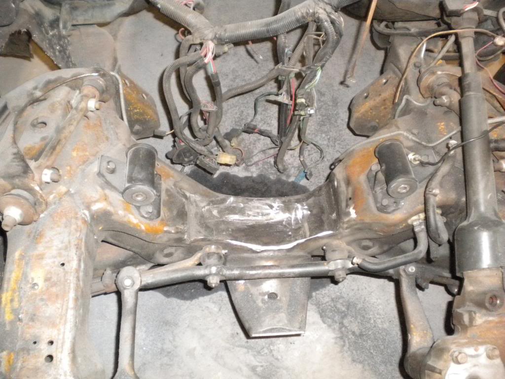

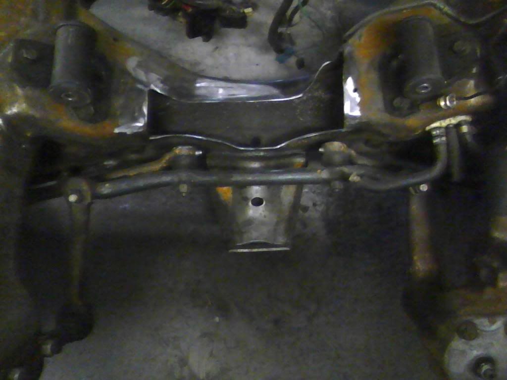

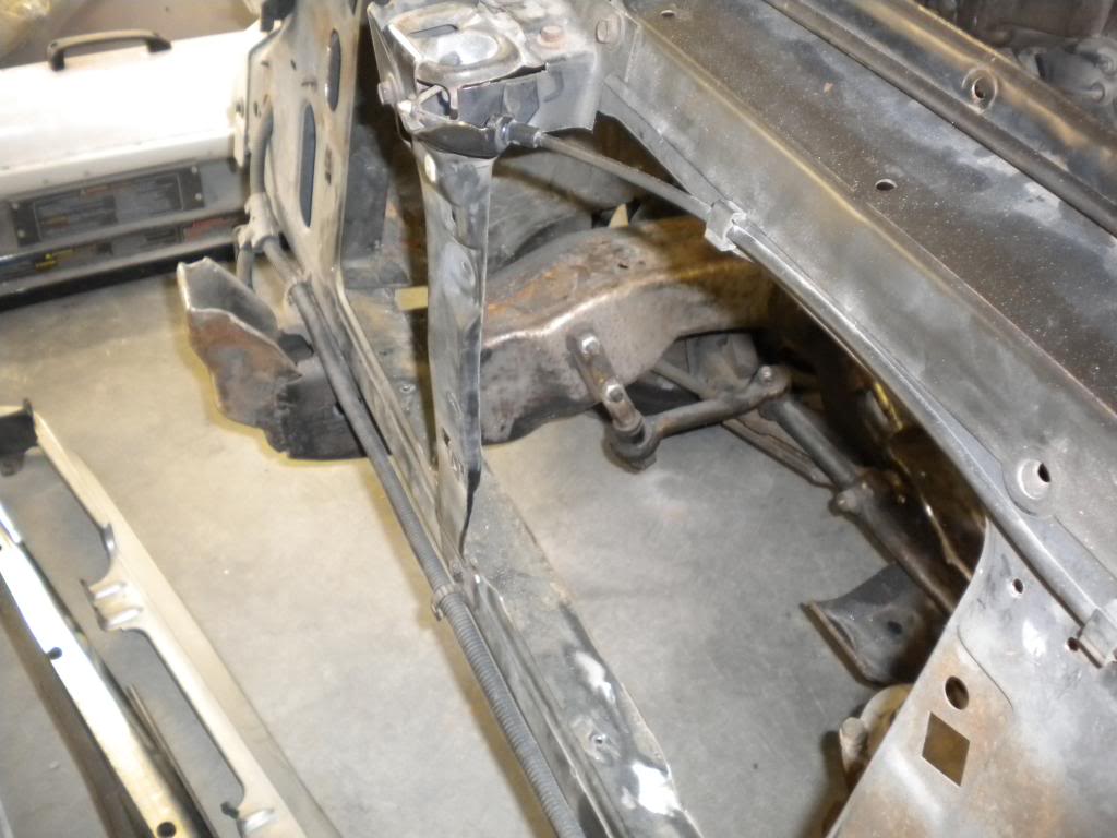

The H3 pan was still a lot close than I liked so I took it on myself to put a small notch in it.

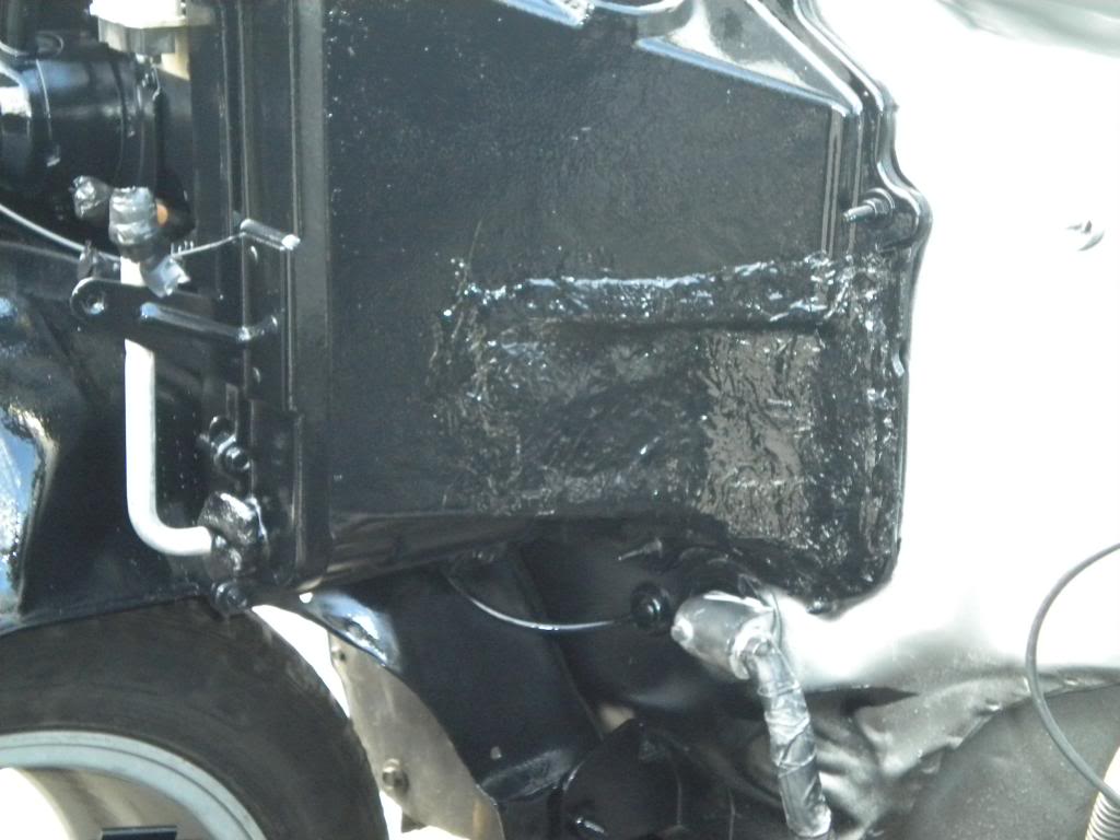

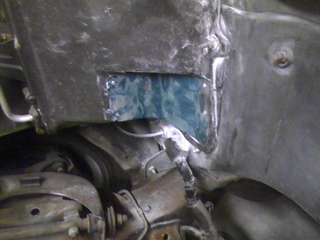

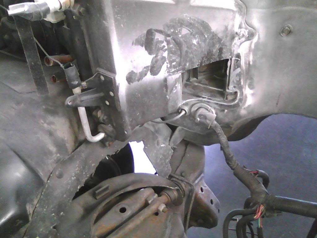

I accidentally may have knocked a hole in the heater box when removing the motor after fitting it up so I cut out that section and notched it also. Makes for good access and removal of the valve cover in the future.
Cut a piece of sheet metal, shaped it to fit and fiberglass the small holes.

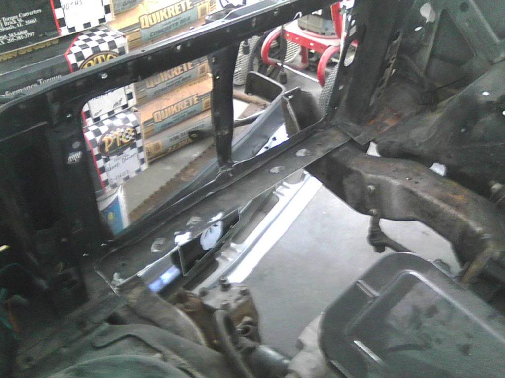

I couldn't afford to go with a nice radiator made to fit. I'm using a 84 vette radiator which required some small trimming of the core support.
Here you can see a oval shaped hole on the core support for the A/C lines
Cut the hood latch brace for my condenser to fit

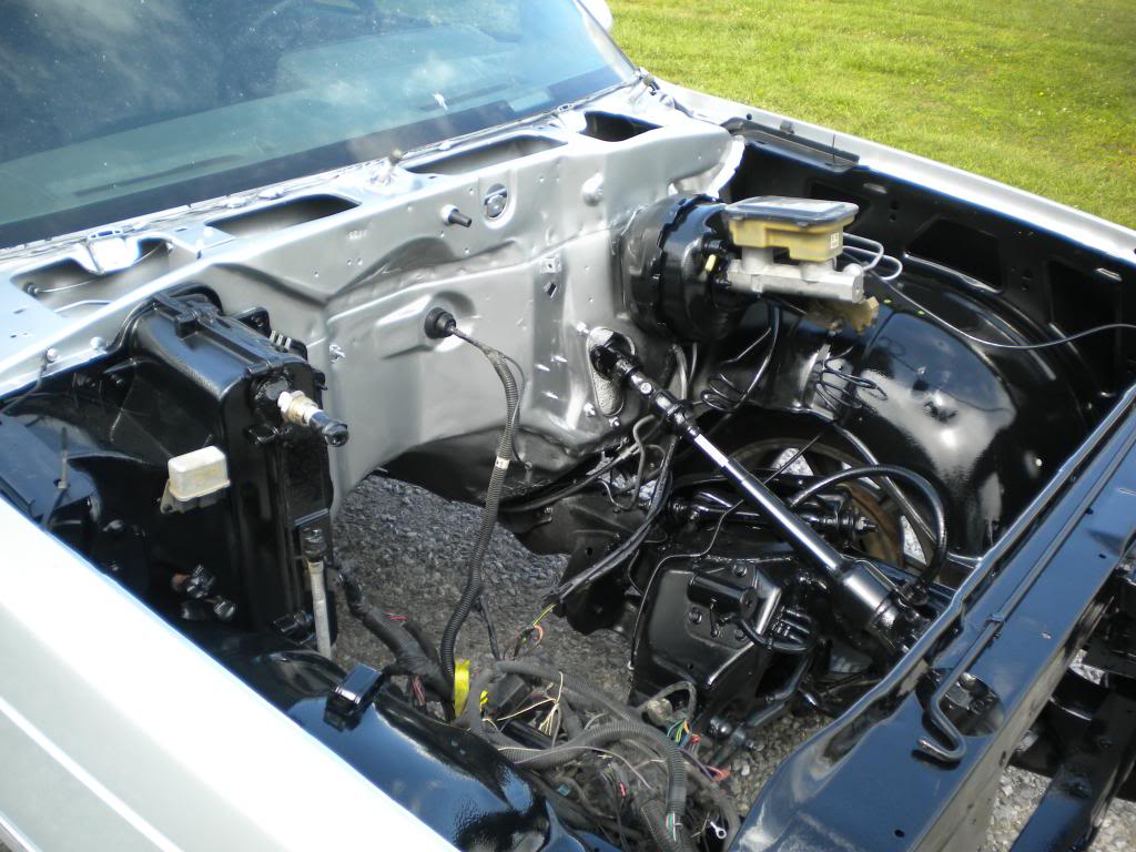

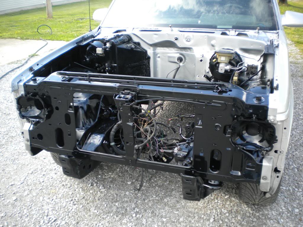

These pics from the day I got it back from the body shop. I'm lucky to have a uncle who owns/operates a custom body shop.

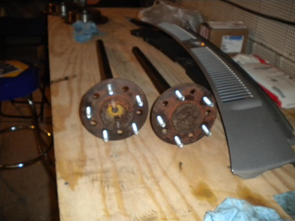

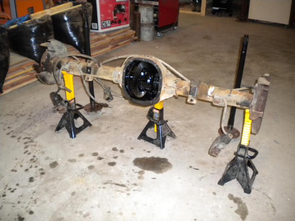

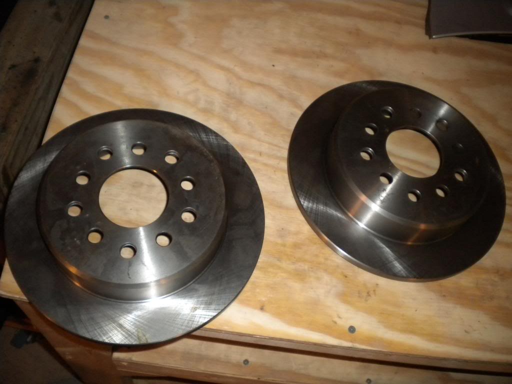

Found exactly what I was looking for on Craigslist. Explorer 8.8 with factory lsd 4.10 and disc brakes.
Got so excited I picked this up for $250! Opened it up, everything ok. Had axles and rotors drilled to 5 on 4.75. Put it back together then decide I want it narrowed so its currently tore down again but here it is.
I will be using the same wheels on rear(originally thought about going wider) but from my. measurements I need 5.5" inches taken out to be exact same as my factory 7.5.

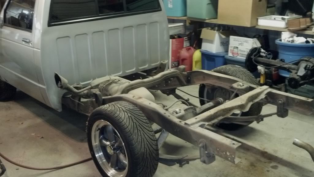

Got the bed off to make it easy to change fuel pump. Gonna it hit with some frame black before I go any further.

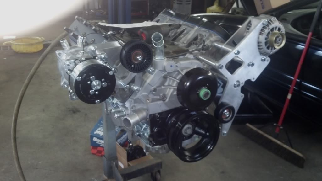

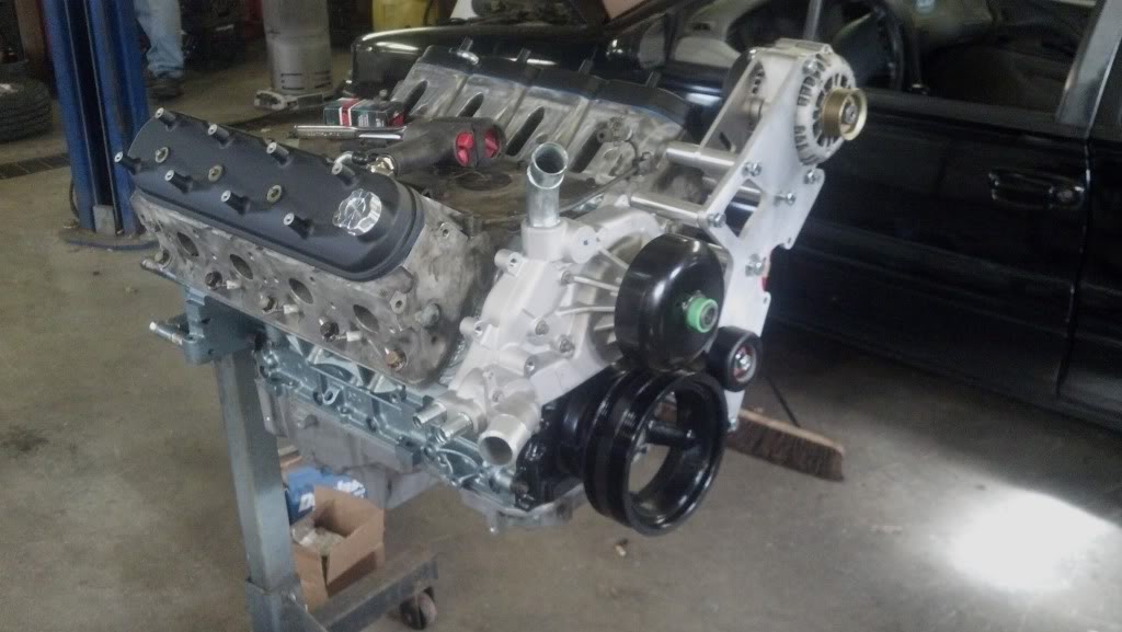

While off for Christmas i managed to get the motor together and mock up the accessories
Kwik performance alternator and power steering pump brackets
Current Performance Wiring A/C compressor
One pulley in the kit was wrong. I needed a smooth pulley instead of grooved but simple fix.
Also had to have a bolt head machined down on the bracket. The p/s pulley was all up on it(why its off in the pic)
