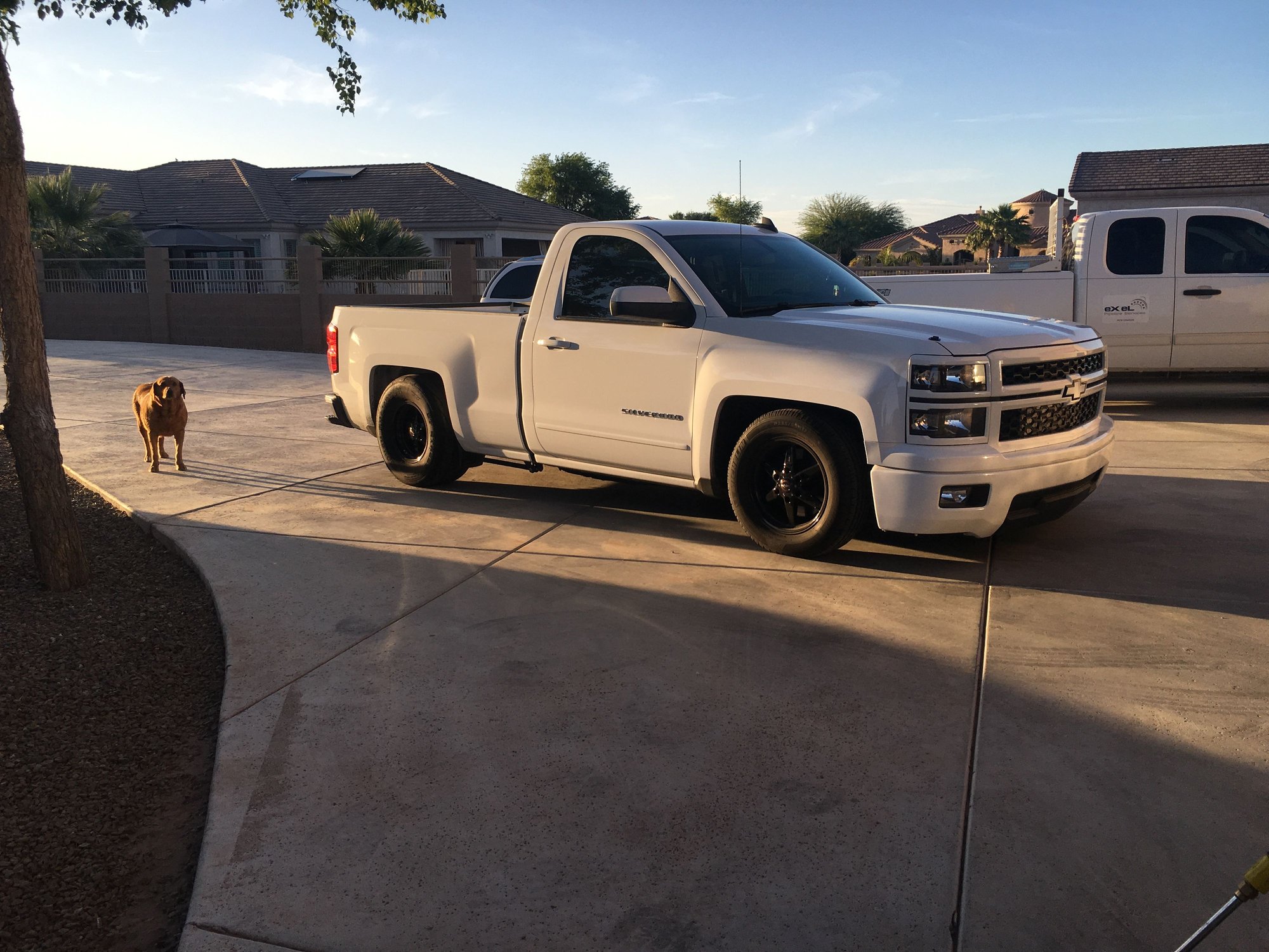

Haven't been on in a while but thought I'd give an update on my truck
Truck made 647/591 in 3rd yesterday!

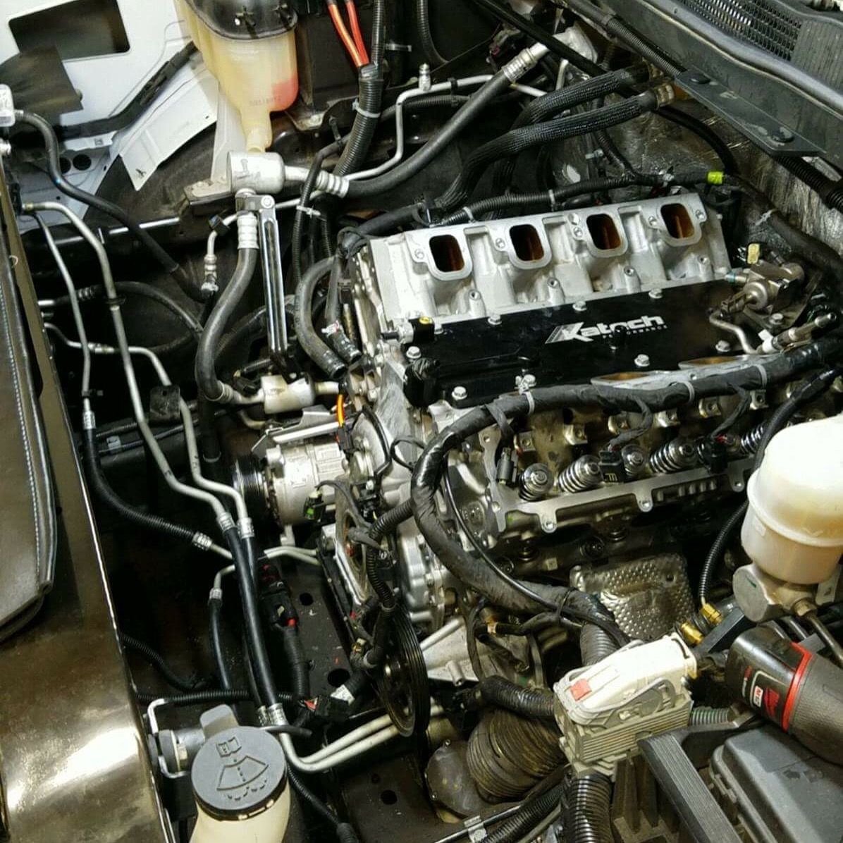

It has the following mods:
Custom grind cam with the bigger fuel lobe/supporting mods
D1sc procharger on 14psi
Lt4 injectors/lt4 highpressure pump
And a secondary external pump for the lowside fueling and she runs on e85
I had originally planned to do the fuel system and leave the stock cam and put it on e85 (because I did not want to put meth on it) but it ran out of highpressure pump immidiately. So i went ahead and did the cam (took 12 weeks to come in )with the bigger fuel lobe and now my tuner said I am at the absolute limit of the highpressure pump (even though it is an lt4 pump)
Just thought I'd share that info for any of you guys thinking of doing boost with e85.
At 475rwhp it ran 12.3@109 here in the shitty Arizona weather, taking it to the track Friday to see what she'll do
Fastest 2014+ truck I've seen so far is an 11.5, does anyone know of one making a faster pass?
