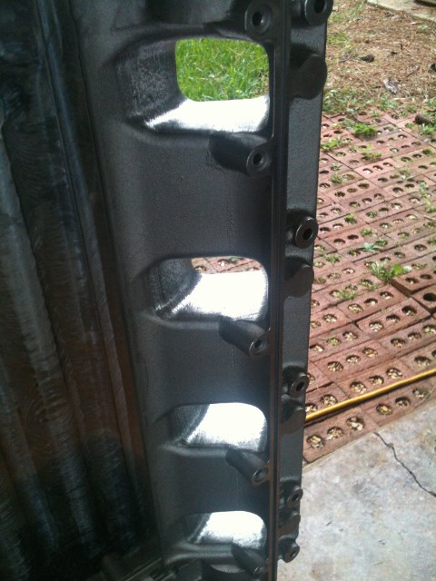

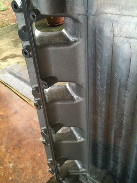

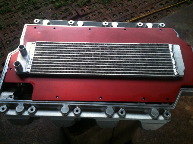

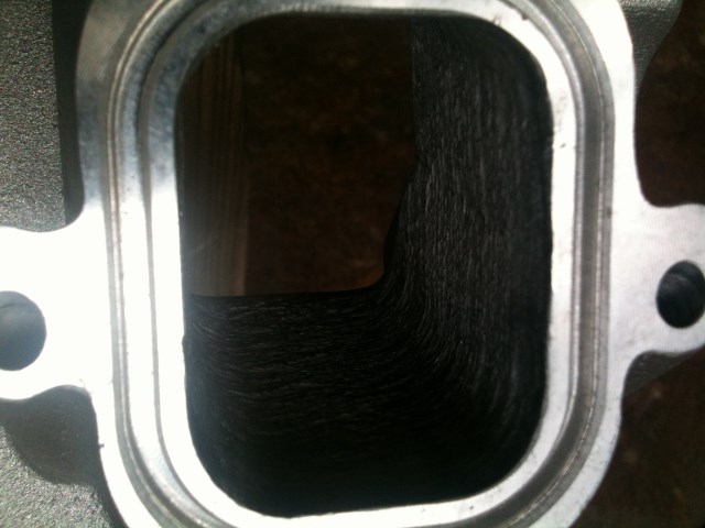

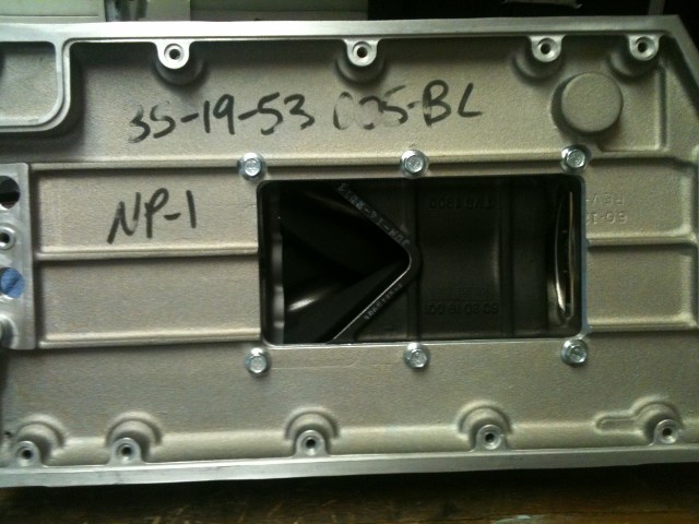

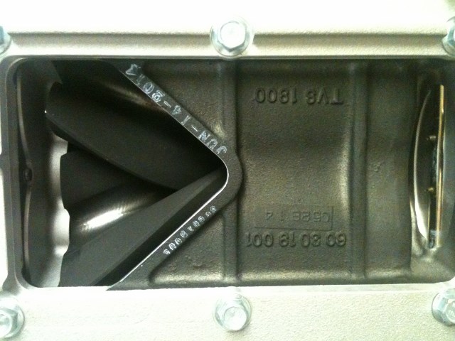

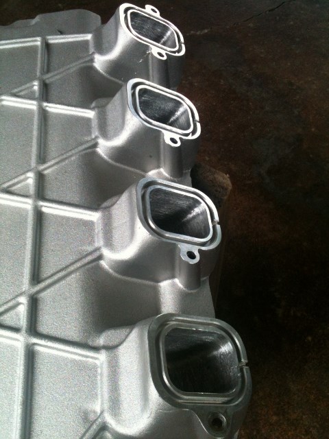

Well here is what I did today...And being I can't leave well enough alone I cleaned up the hideous ports on the Stock TVS1900 manifold. softened the short side radius and blended the port where they CNC the opening. I doubt it makes anymore power but It has to be way more efficient. BTW the cooling Brick is on the small side at 15"x 5"x 2" and here are some pics for those that have never seen the inside of a Blower before
REALLY??...haha You come from the drag race world so no big surprise,ya cant just toss it on, you have to massage it stroke it,caress it and finess it
Its cool man as long as you get it where you want it.Good job on the reporting

Yeah it's a sickness I am plagued with... I mean who in the hell takes a brand new blower apart to molest it?

Great job, it cant help but make more power than stock
