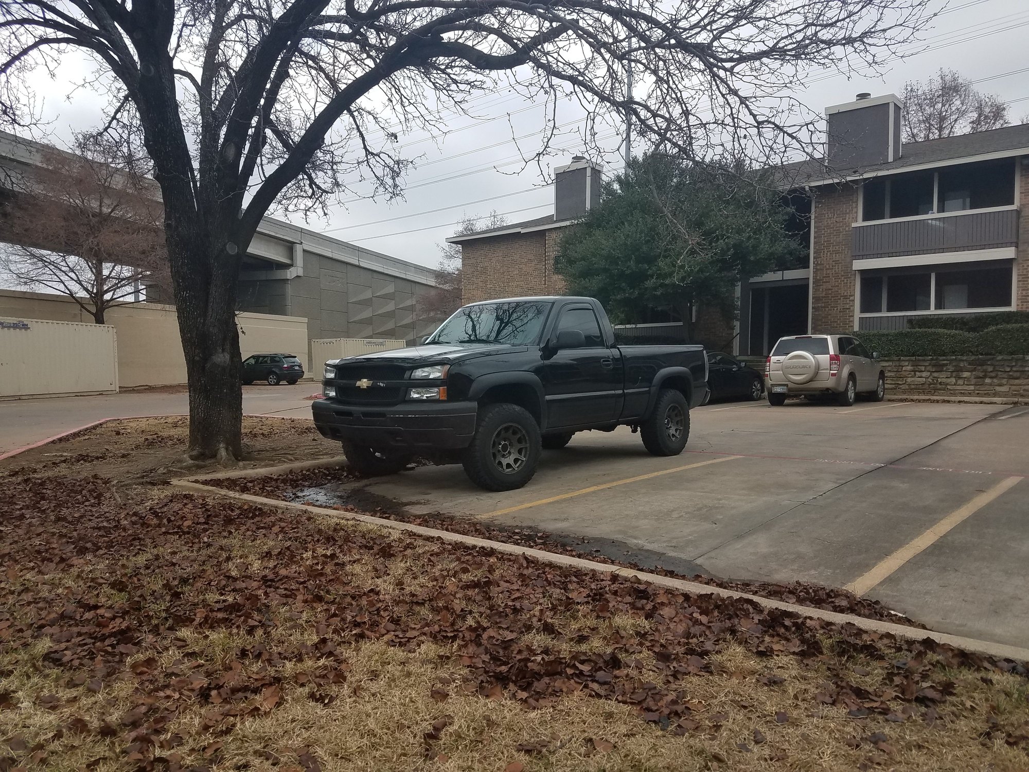

I've been reading up as much as I can about going with coilovers on an '04 Denali. I found a bunch of threads about lowering but I'm interested in going up. I'd like to lift it roughly 2.5"-3" over the current cranked torsions. The only image I saw posted of your truck is in your profile. The ride height in that pic looks exactly like what I'm after.
Do you know what the center to center measurement is on your shock at that ride height?

Here's a recent picture of the truck. I think right now it only sits maybe an inch or 2 over stock height. But with this set up I could crank the coil overs up atleast 2inches higher if I wanted maybe more. I'm running 6in coil over shocks. I can get you the measurement later today when I get the will to go out in the cold

sorry for the late reply its been in the 20 the last couple days and I hate the cold. Went out today and got to a mostly level spot to measure. From eye to eye at ride hieght my shocks measured at (15 7/8driver side) and right at (16in passenger side). Hope that helps any other questions let me know!
