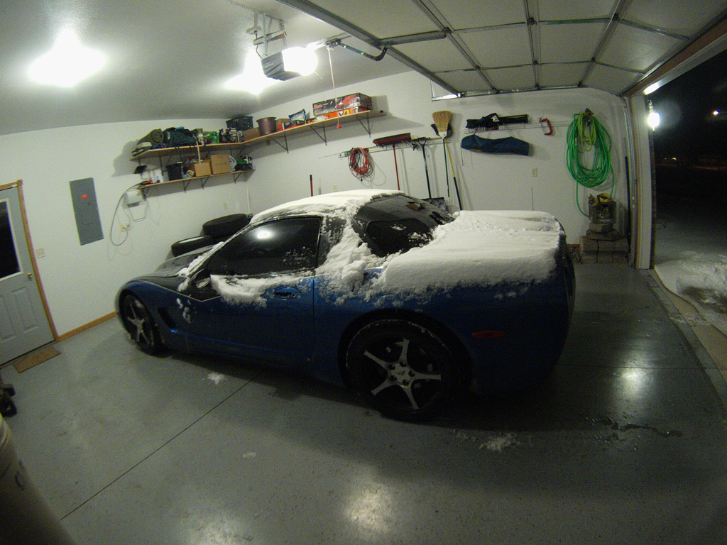

haha, thanks. that won't be happening any time soon. waaaaaaay too much of my life invested in Penny to get rid of her for something this trivial.
besides, i can't keep doing this much longer
