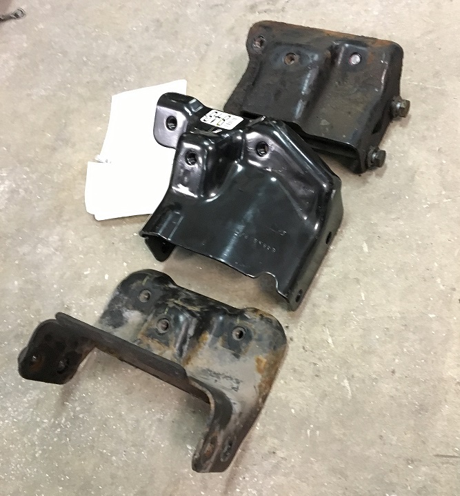

Driver side motor mount identification (1500 models only).
Top mount is coil spring V6, middle is coil spring V8, bottom is torsion bar V8.

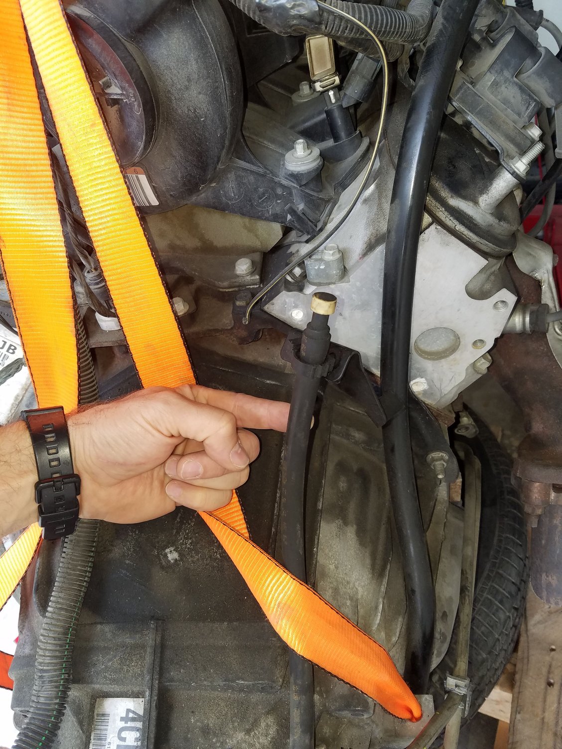

I have an 07 classic that I'm putting in a 5.3 from an 05 suburban. I grabbed the trans with it for simplicity of the swap. Both are return less fuel so that makes that simple. Both already came set up to run e-fans so that helps too. My questions are, will the frame mounts for the suburban work for the silverado or must they be silverado mounts?
also... where does this connect? I don't think I see one on my v6... though I haven't pulled it yet to be sure.
and what the hell is this even?
Comes from the trans.

1. Is the EVAP hose that leads back to the tank. On the V8's the 3/8th feed line and the EVAP line come up together on the rear of the motor.
2. That is just the breather for the transmission, they place it there so it's far above the fluid level to vent it and to not get crap around it and plug it up.
