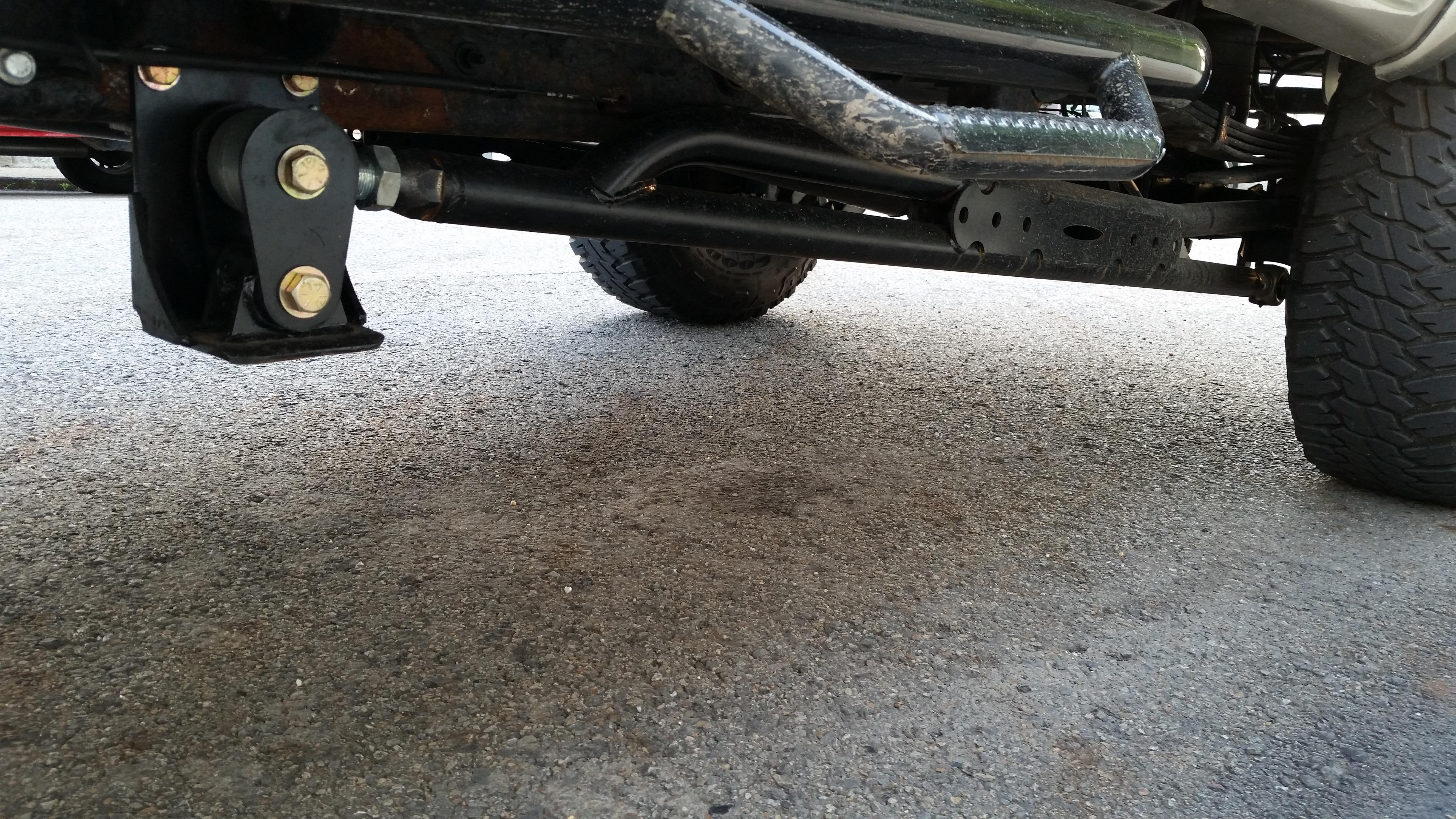

I am lifted about 2inchs with 33s and had terrible axle wrap and wheel hop with an AAL no blocks and bilstien 5100s (which are to stiff). I added an Off Road Design shackle style ladder bar And it completely cured my wheel hop and axle wrap. The ride quality is just the same and nothing seems to bind. I had to have a custom cross member fanned up for it but all together it cost just over $500 and that's everything powder coated as well.
Not my truck but same ladder bar and shackle.

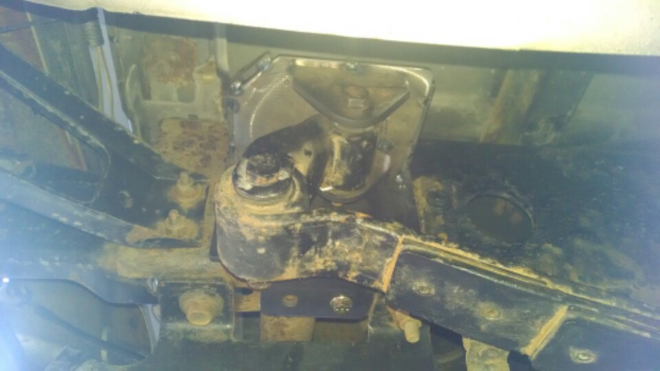

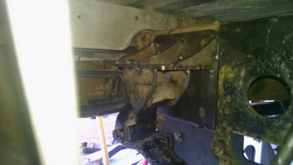

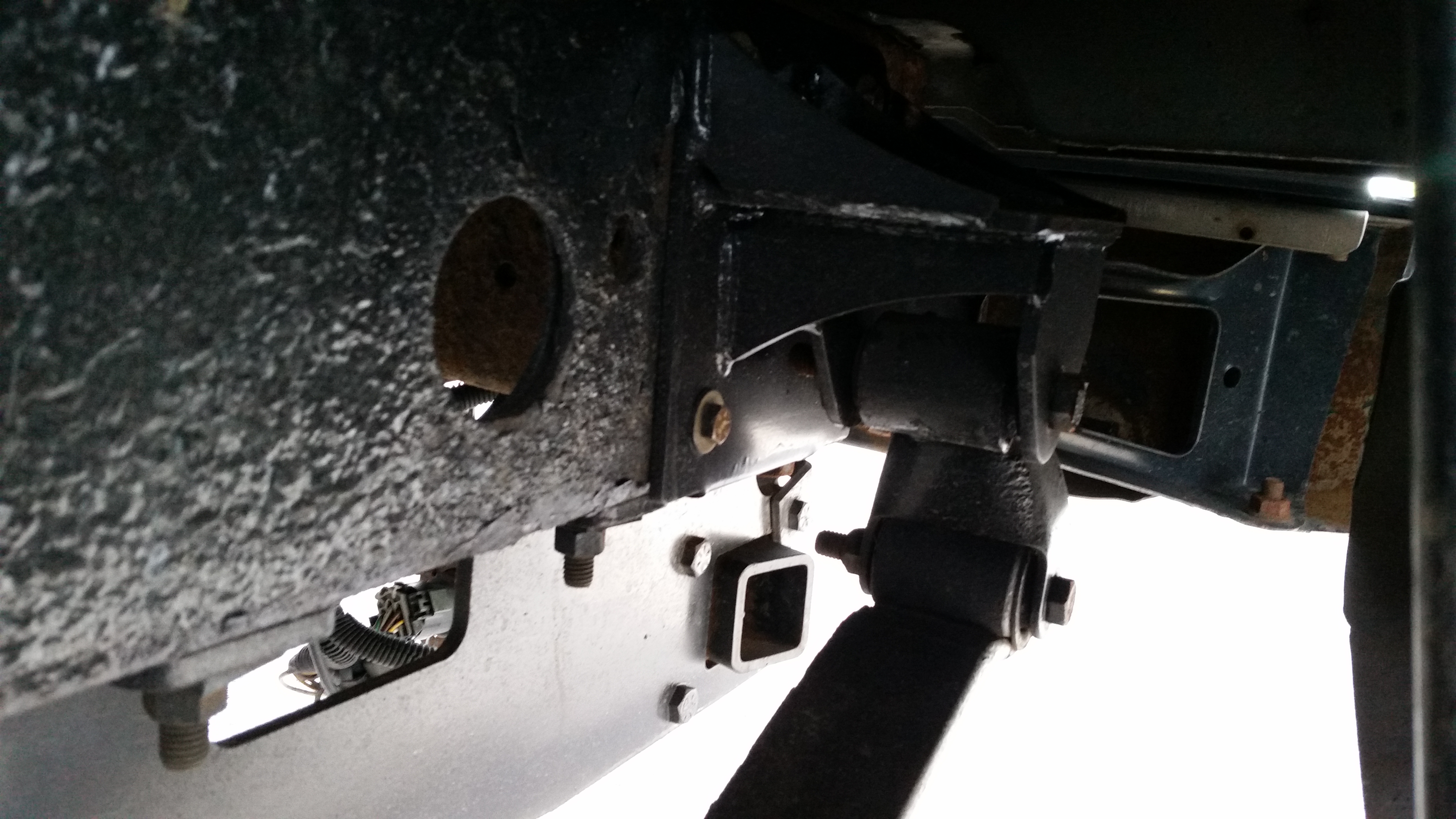

To clear up any misconceptions. When using "long bars", if the front of the bar is in a fixed location, and the rear of the bar is fixed to the rear....there is no "optimal install height" that prevents binding 100%. In a leaf spring situation, the rear doesn't particularly "articulate". Its movement is far closer to "up/down". The shackle is there to absorb the spring length when it gets longer from compression. If anything, the rear will move rearward on compression as the front of the spring straightens out.
Now the "long bar" does move in an articulating fashion. Fixed at the front, the rear mount will articulate. As an example, if the bar where parallel with the ground, any movement up or down will cause it to "pull" the rear forward as the rear mount gets closer to the front of the truck with movement in any direction. Think of a panhard bar. A panhard bar does some work keeping the rear squared up, but it does push/pull the rear as it moves. Obviously the longer the bar the better as it will be travelling along an arc that is far less severe. This is the same concept used to set up valvetrain components. Draw a circle with a short radius and then a large radius circle next to it. the arc is less extreme.
Because of this, when I was planning mine out, I made a pivoting shackle for the front mount to allow back and forth movement to keep everything from fighting each other, while still allowing the bar to help control the wrap up on the front spring.

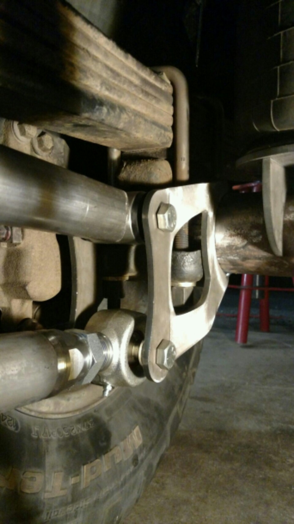

My hd is lifted 7 inches, I had bars made at a fab shop for both sides out of 2 inch dom with rebuild able joints and poly bushings. Also shackles in the front so everything moves with the suspention. I has a set of bars before that were tube and heims, my opinion they sucked and made the rear ride harsh. Another thing done to the rear suspention was a shackle flip, basicly for lifted trucks only. Makes the suspention softer and you can use a smaller lift spring to achieve heigth. Since it's softer air bags were added too.
