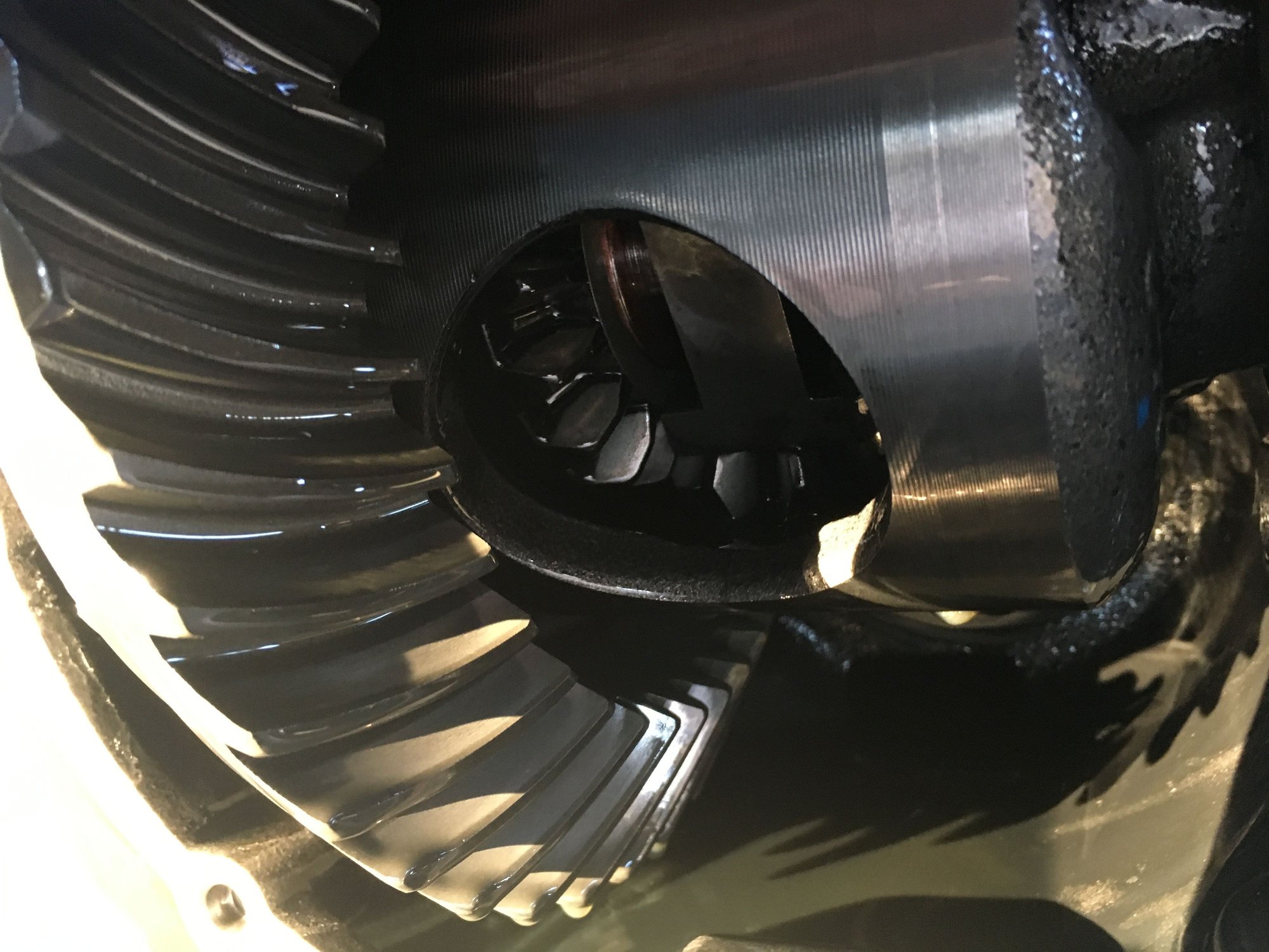

about 800 miles ago i had a AAM 3.73 put in my 10 bolt chevy rearend. I went from 3.08 to 3.73. installed called and said he thought the gears were cut wrong and there is a little whine. Got the truck and there is whine on decel between 50-35ish. Checked the wear pattern and it looked good to me and many many others. Oil was clean and not much on the magnet. ECGS said that once it's started, it will always whine and if it stops to be concerned because something changed. I'm nervous that once i put a trailer on it, it will be bad news. I've been thinking about taking it to another shop to have them check it out as the installer is very insistant that his install was by the books and it was the gears. ECGS said AAM is the go to gear for them for quality and quiet gears.
I don't hear a thing except on decel between that mph range. Going from 75 down, its quiet until i get to that range.
What should i do? Live with it and hope it quiets down. It's not that bad but any noise bugs me. I've heard stories similar to mine that it went quiet after a few thousand miles. I put in amsoil severe gear in and no change.

Sounds to me it was not set up perfectly... from my experience in building 50 + rearends over the past 16 years as a tech, it sounds to me that there is slightly to much backlash causing the whine on decel... chances are it will stay like that forever without any issues other then the noise... if u have or can borrow a dail indicator measure your backlash, its should be between .005-.008"
ok, thanks for the info! Does the wear pattern look ok? Since i have 800 or so miles on it, a backlash change won't affect the noise due to the fact that my pattern has developed? No chance of it just going away?

No problem! I've been down this road before lol. Wear pattern / pinion depth looks good... chances are it is just slightly out. I would start with a measurement with dial indicator for backlash and go from there.. if it is in fact let's just say .0010" (too loose) u can try re shimming the carrier over slightly to tighten it up a bit basically without affecting your New wear pattern. Just enough to get rid of the whine...
