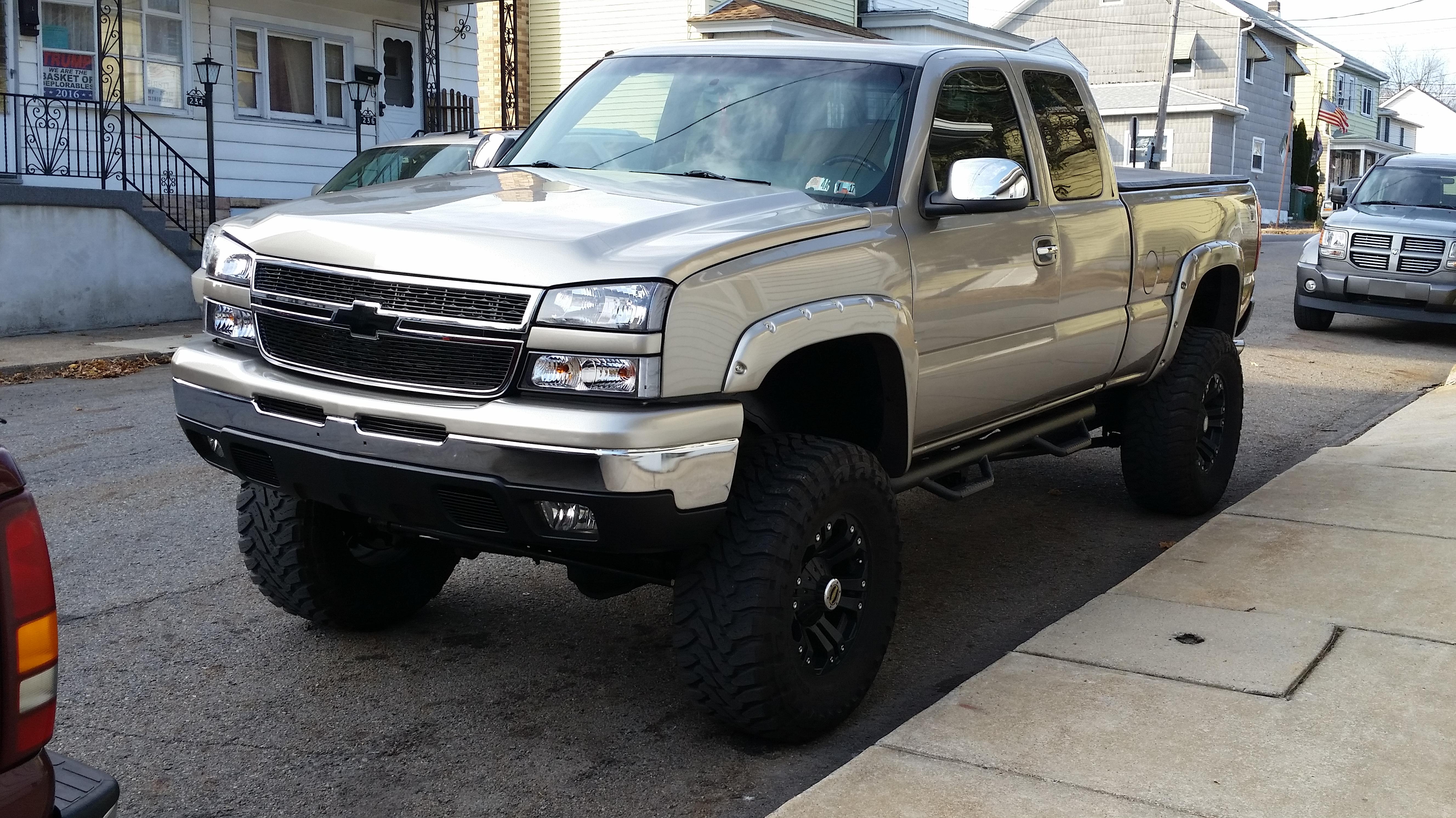

That looks great, here's what the trans is for. Like I said it's not a small truck. I just changed the front end from an 03 to an 07 classic, clear headlights and raised the bumper with a 1500 cap. Same pic to the left..
