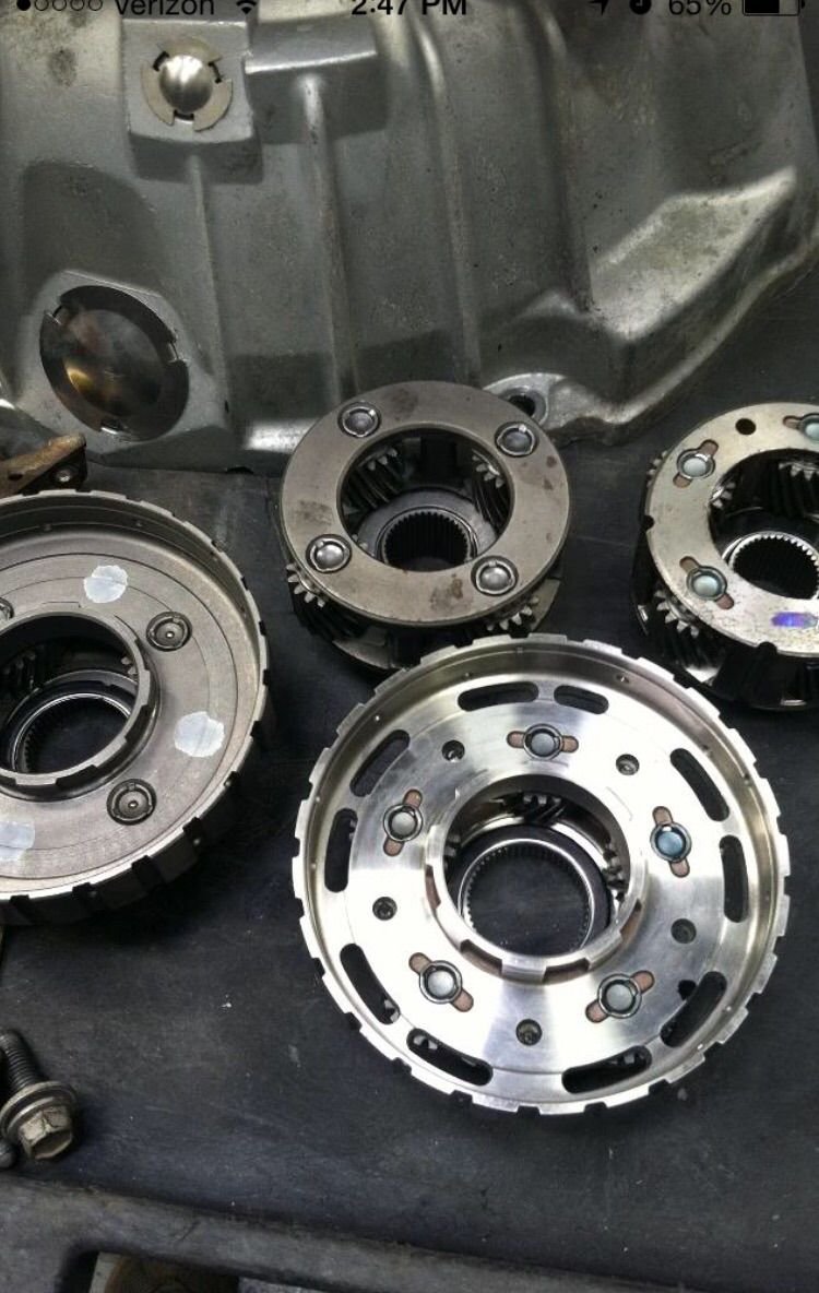

Lvl5 with billet planetarys - the 4 gear cast set fractures easy
Agree on gear change also
Or save the headache later do 80e swap like I'm now having to do

It all depends on the weight of your vehicle and the amount of power you have. I personally like 4l60e's BUT they just cant hold up well in 4k plus lb vehicles with a lot of power . A 4l60e rated at 800 hp will hold that power just fine in a 3000lb car. Putting that same trans in a truck / heavy rig is like throwing an extra 200 hp at it. The weight kills it.
I had a 4l60e hold for awhile with over 1k hp. It wasnt if it was going to fail, it was when. You can keep throwing all the expensive billet parts in it and then you will find the next weakest part. The post of 4 pinion planets being weak is false. If you set it up to shift crazy hard yeah, your going to break the planetaries. I have seen and broke more sets then you can believe. I only broke 1, yes only 1 set from overpowering it. At the track, 900ft lbs of torque in a 4500lb vehicle. Keep the shifts crisp but not hard, and keep some torque management in it.
A 4l80e isnt the solution for everyone, but if you like to just put it in and forget it, have the piece of mind knowing you don't have an egg behind your engine, its the way to go. People want to save you the headache and save you money too by suggesting the 80e .
