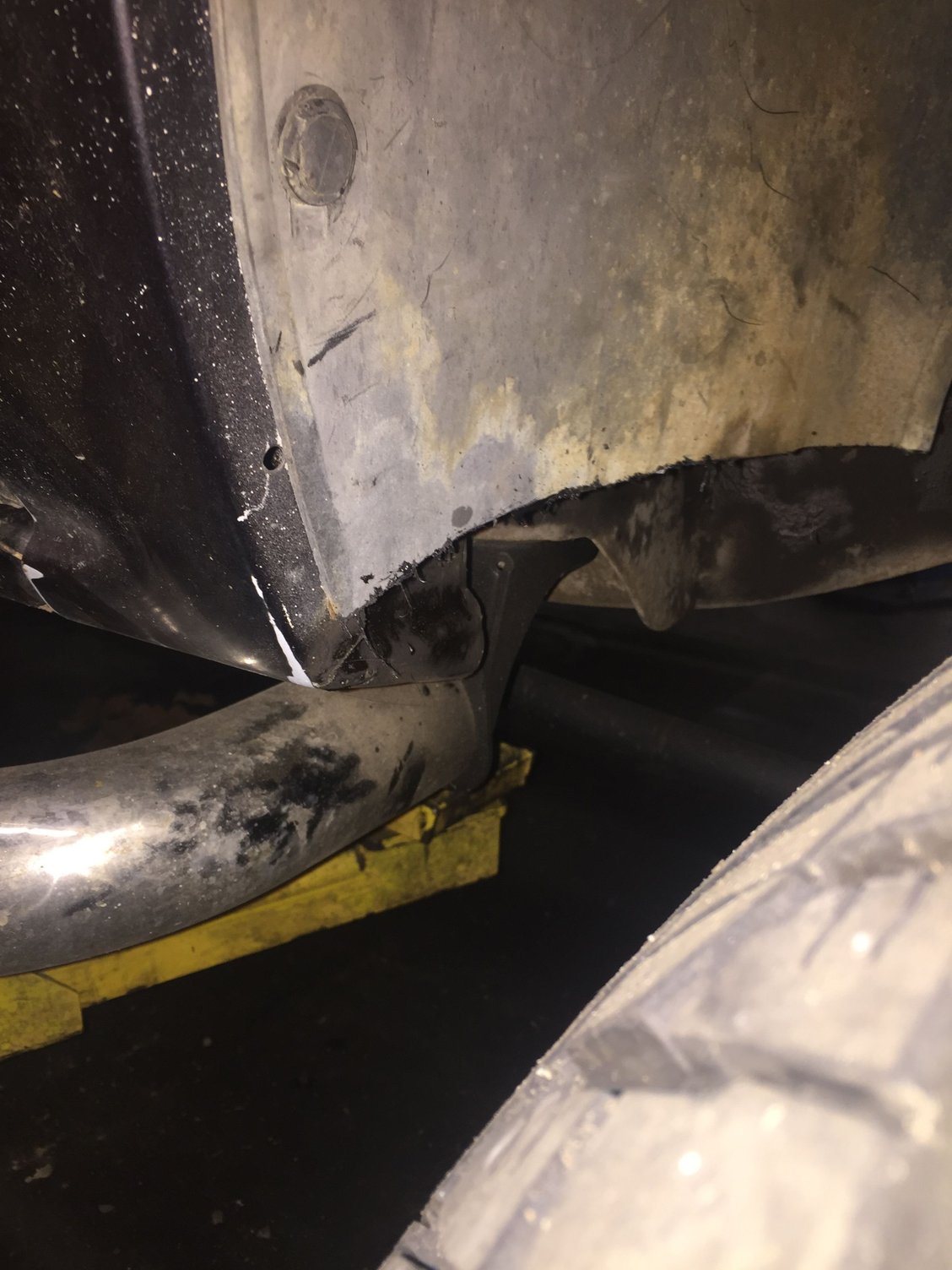

So, i got tired of dealing with a few things that were really kinda bugging the crap out of me, that mostly due to my own lack of time and motivation (or maybe shear laziness) havent been taken care of yet... namely connecting the second battery, and modding my fenders(cutting them, clearancing them whatever you wanna call it)
Passenger/auxiliary battery, finally connected, only been in the tray for about 5 or 6 months, and not hooked up, was trying to wait to get the headers installed but 19* last night made this a bit more pressing....
Driver side main battery
Half *** pic of both batteries installed
And the passenger side fender and inner liner moved and trimmed.... harsh turns (like everymorning keaving the house) the tire would just barely touch the last 1/4-1/2 or so of the fender itself and the fender liner would get pulled up from the fender.... killed both birds with one stone... havent done the metal work to the left fender yet, just trimmed the liner... overall much better i actually did a few lock to lock figure 8s in the parking lot at work when i was done...
Thinking brake lines will be in next week or so, along with a new master cylinder, repaired abs module and more than likely new brake hoses, then shortly after i hope to get the engine mounts replaced and headers in....
