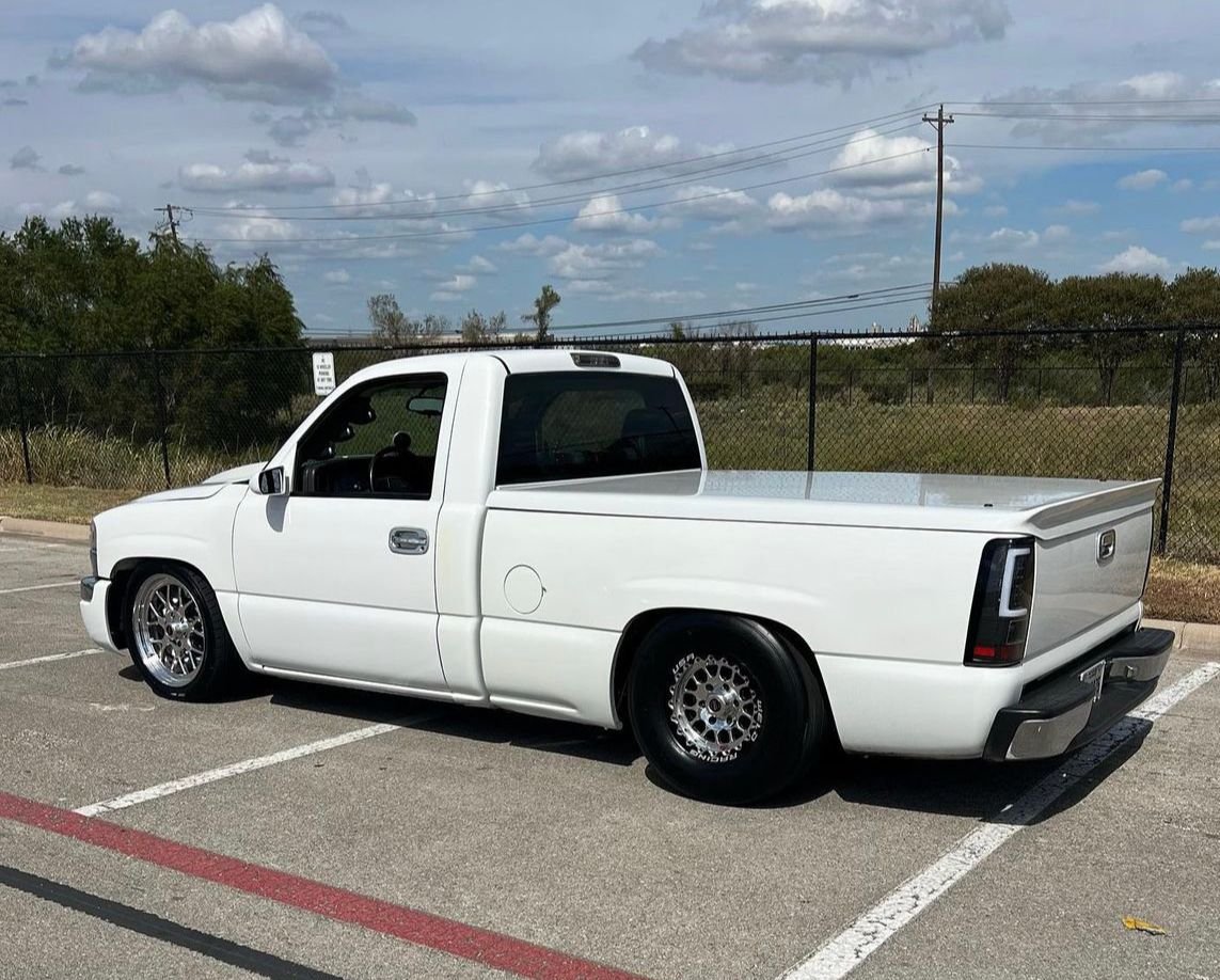

Im running a 295/65R15 on mine but its always had big tires on it 30+ inches lol.

Do you drive the white Silverado around town like that? How's the drive? Also are those what rims do you have in the rear?

Yes after i found out they like 18-20 psi, on the highway 30-32 psi. To tell you the truth my truck just rides stiff even with the tires at 20 lbs lol. The wheels are Cragar soft 8s 15x10 with the work truck chevy center caps the truck originally came with.

How much drop do you have?

4/7 with flip kit and clamped overload leafs to prevent them from hitting the assasin bars at full suspension droop.
