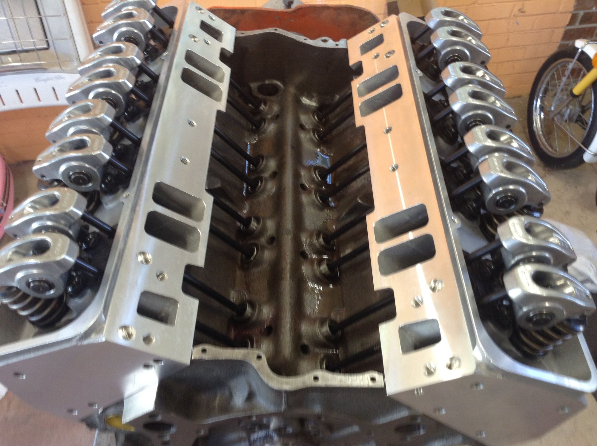

383 stroker scat rods and crank 60 over 010 block line bored and decked
Nkb 202 160 200 heads 68cc with pbm race valves
Thumpr cam
Comp rollers
Comp double roller timing
Wiseco -12cc pistons
Arp main studs
Procomp intake
Demon 750 carb
Turbo 350 stage two punisher with tci breakaway

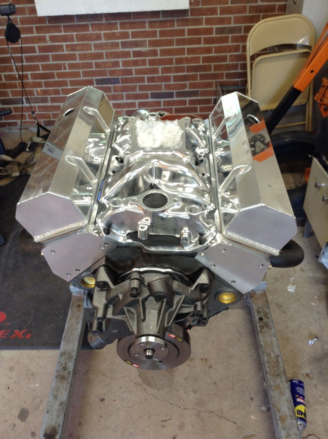

Finished up tonight. More pics soon

Man those valve covers are taller than the heads, lol!!! Looking good!!!

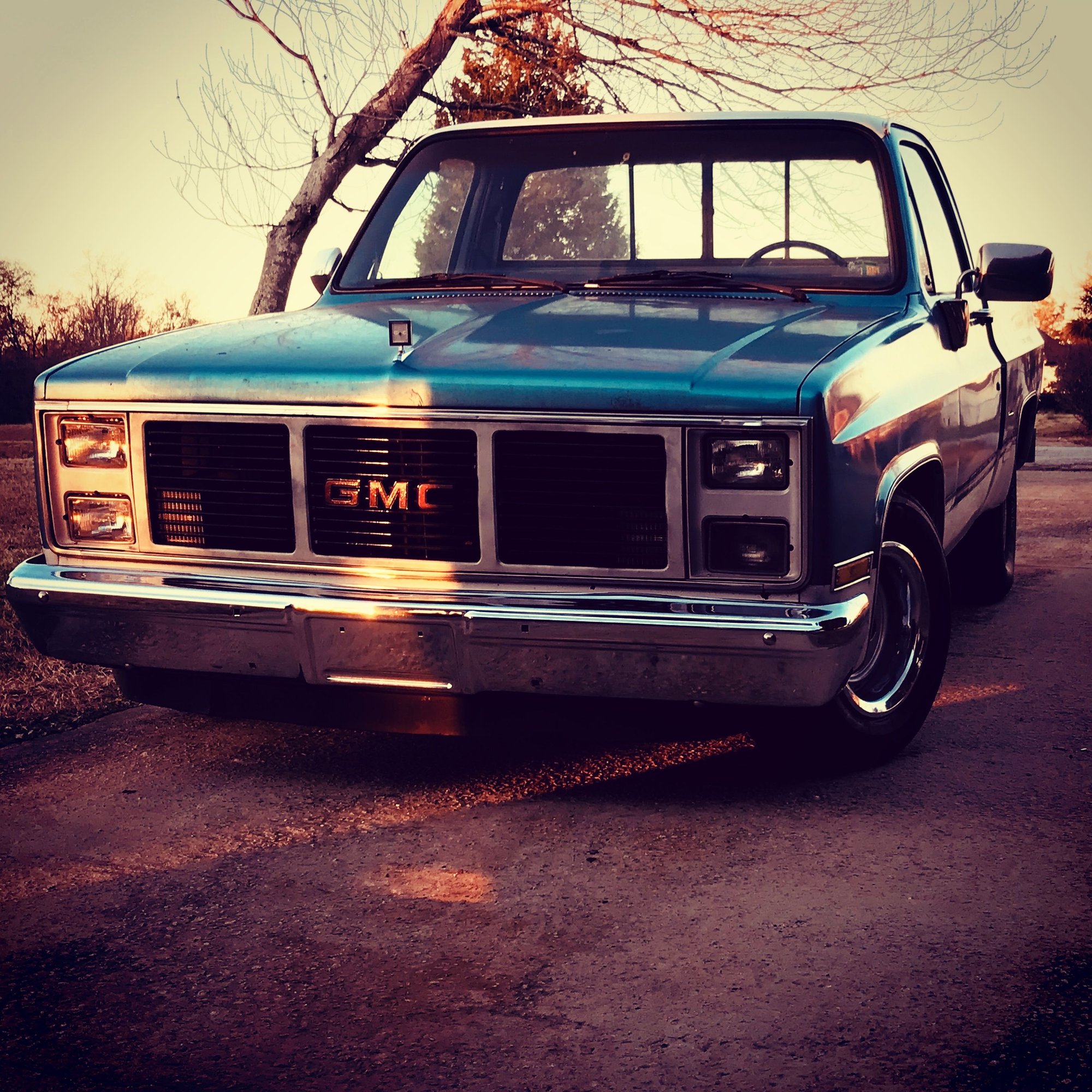

Default Lowered now!
Now she is down.
Western chassis 4-6 drop with c notch.
