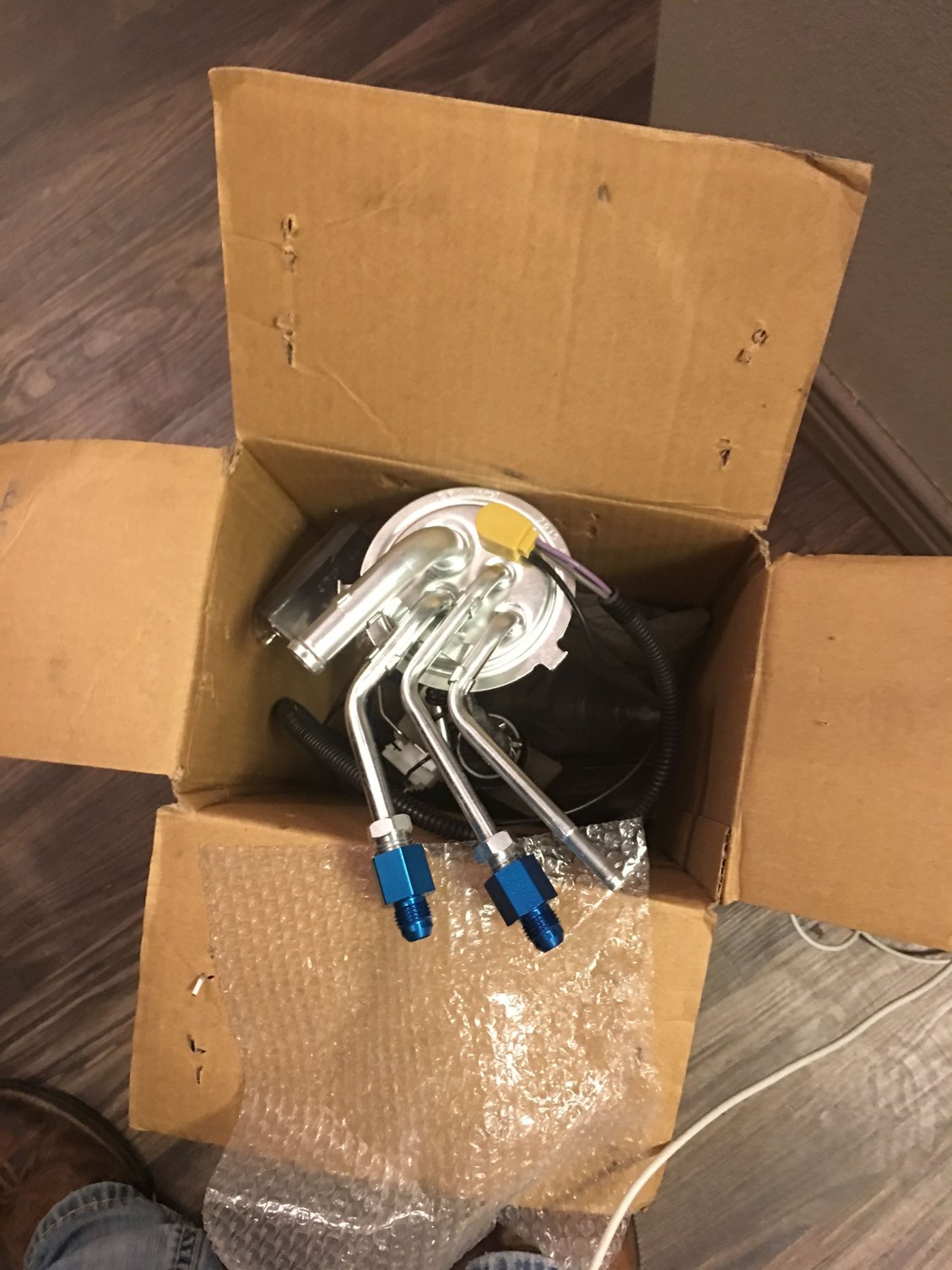

I am using a 31gal K5 blazer tank from spectra premium under the bed, with a corvette filter/regulator.
Triangulated 4link
Lokar Shifter
Used earls fittings to adapt from metric to -6AN

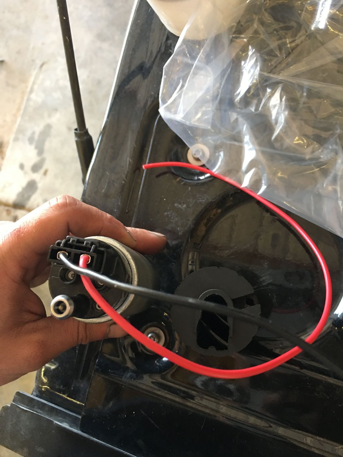

Walbro
Walbro
Taylor spark plug wires
Spark plug wire sleeves
Earl fittings metric to -6ANfor sending unit

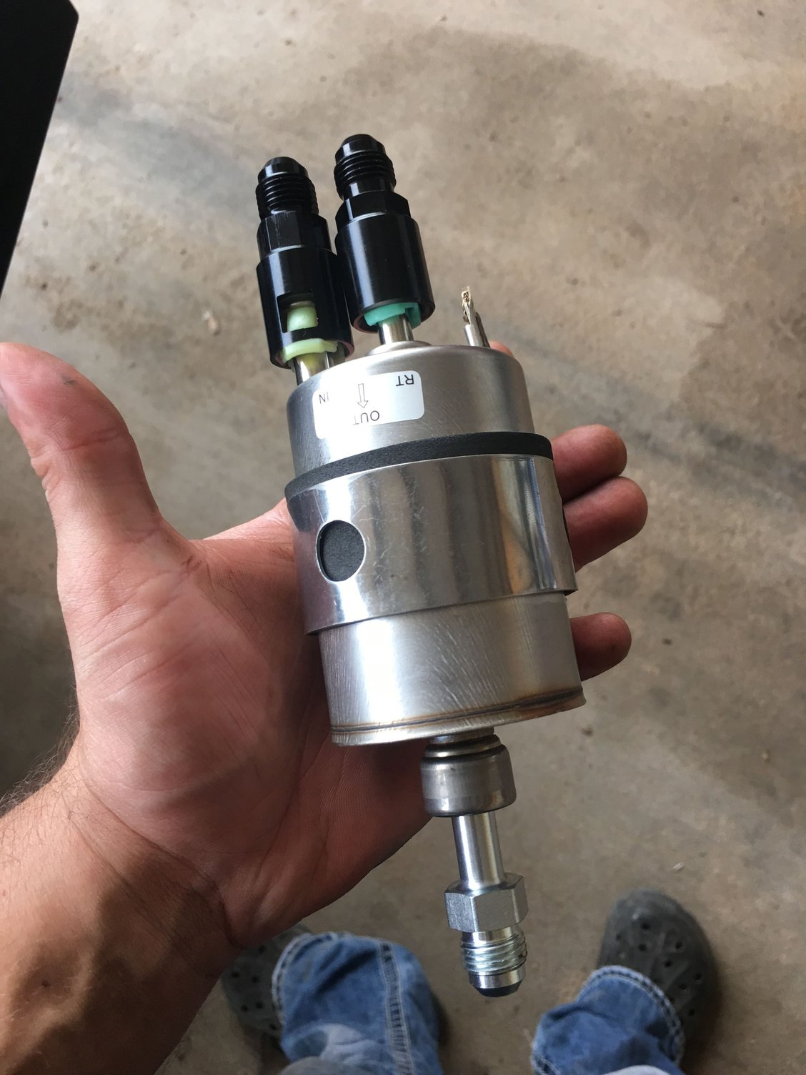

Corvette filter/regulator

we just used that corvette filter setup in my kids '94 RCSB we installed a lq4 in worked out pretty good really made things simple!
cool truck!

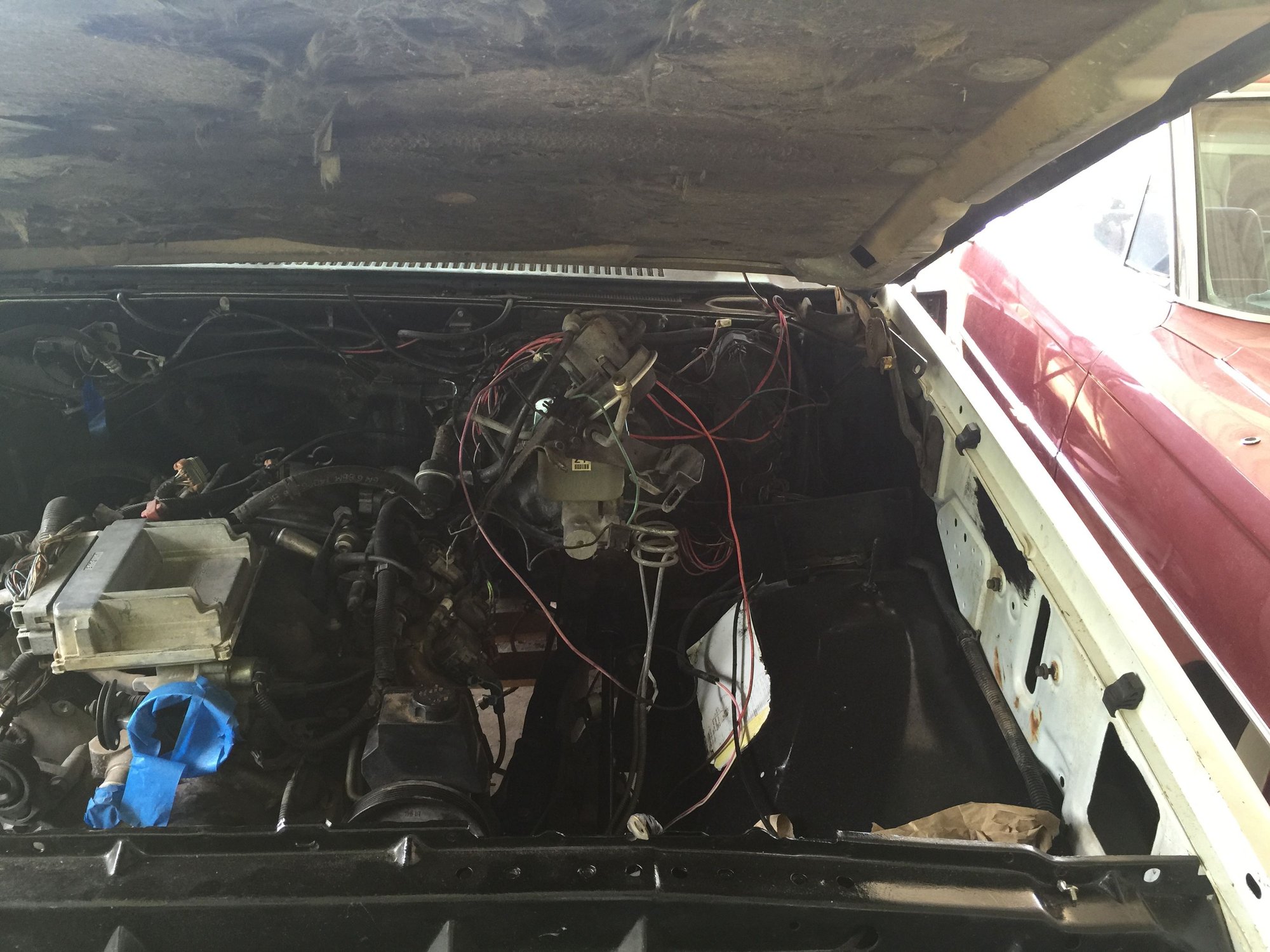

I worked on the throttle cable and pedal yesterday. Removed the old throttle cable and the throttle pedal. I am using a Lokar 48" LS1 throttle cable. I had to mod the end of the pedal to work with the clevis at the end of the throttle cable. Originally it ran parallel with the firewall and had a split at the end of it. I used a mini inductor to heat it and close the gap and twist the end sideways.
After removing it from firewall
Old cable
